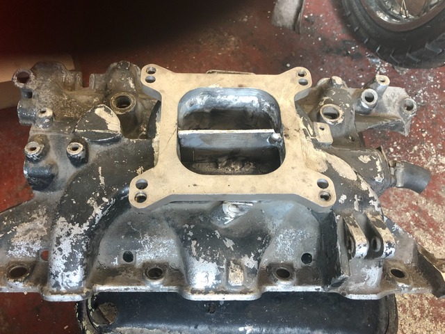

I've machined several RV8 manifolds, mainly for 4 Barrels, there should be some photos in my archive, I did one a couple of weeks ago to make a bit more cash from left over parts....
rv8holley2
rv8holley2
There are also some modified efi pics in there.
