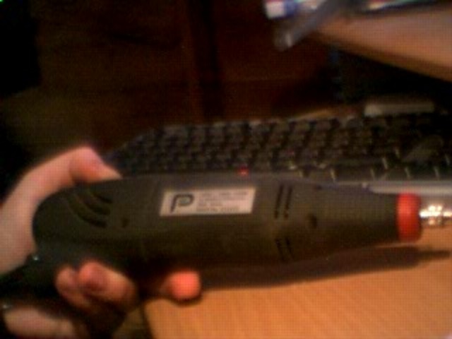

paul_mcq
posted on 5/4/05 at 05:04 PM |
do u think this would be able to do the job? found it in my garage, it's 140w and goes upto 27000rpm from 8000let me now. cheers for the info so
far
![](/galpreviews/4MyPicture001.jpg) ![tool](/gallery/4MyPicture001.jpg) tool
RogerM
posted on 5/4/05 at 05:15 PM |
It would work, sort of ... take hours, constantly glaze the stones due to not being able to put much/any load on them or you'll slow the grinder
to the oint it doesn't work/blows up.
Air die grinders the only way to go ..... ne LOADS of air though but will do a good job.
Be careful .... not easy to put material back and there are some engines out there with ports that are too big to start with!!!!

Avoneer
posted on 5/4/05 at 06:34 PM |
Thats the tool you want - the one you got - with those little rubber black drums with sandpaper on them. That's what a friend of mine uses to
port his heads and he has done quite a few.
