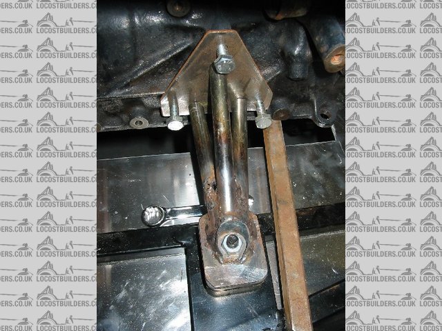

started on my engine mounts on sunday evening. I had popped round ot see James for some 3mm plate (thank you James) and he didn't think my idea
would be strong enough, i've made a start, anyone care to comment?
I recon it should be as strong and possibly lighter (apart from the extra welding!) than one larger tube which appears to be the norm..
I must admit getting the welder tip into the tight bits was a bit of a nightmare, clark don't seem to do a tighter shroud that i can find though

Hi Ned
Your welding looks far better than mine but even so I'd be concerned about the strength of the outer joint. Lots of weld there - are you sure
it's penetrated properly? On the close up photo I can't see much evidence behind the nut - I'd expect some heat discolouration here,
unless you have painted it?
Other than that it looks a pretty neat design.
ned
posted on 17/5/05 at 01:44 PM |
i'm confident in the pentration of the welding, you can see discolouration on them first hand jon ( i might try and get a small bead round the
inside aswell).
the spatter is from where i was trying to get into the hard to reach bits and a combination of missing on occassions and having the wire spped a bit
high, i'm also slightly out of practise, they will look a lot better once tidied up and painted..
Ned.

Should work ---

as long as you have kept the original engine mount geometry , theyll be less torque on the mount . If you changed that , you may end up with a roll
couple in cornering , putting more stress on them .

Ned - What rubbers are those ,and how high are they ? , my bouncy Sierra ones keep causing some amusment!!!
The mounts look feasible , you've got a bit of diagonal there ,so your not just relying on the welds, mine come straight out but i put a
gussett on the top to try and get the same effect. if i'd used thinner mounting rubbers I could have got more angle.

I think they're fiesta mounts, they feel very stiff and i think must be about 30-35mm thick (can check tonight if you like)
The piece round the bolt started life as 1.6mm sheet, i cut a piece out and bent it round a 19mm long reach socket (to give clearance for the 17mm
socket that the nut requires) with a mole grip and by hand/hammer. the round tube is actually from b&q! i think its 16mm x1mm thick iirc
Ned.

Neds design is pretty much like some caterham mounts i have seen,they used the 3 bar system too.

dont like them ned,they are too "straight across",coming down at an angle is better,as you cant really do that hows about some 3mm plate
cut into triangles to take place of the small tubes

sorry conrod, but 3mm plate, yuk! how heavy!!

Ned, they're overkill if you were to ask me (which you probably had no intention of doing!). They look as if they could support something much
heavier.
I prefer a single tube like NS Dev's, though angled down like theconrodkid said.

posted on 18/5/05 at 10:15 AM |
Pretty sure they're Fiesta gearbox mounts. What MK have been using for years.
They're about 40mm tall.
James
- Muhammad Ali
James
posted on 18/5/05 at 10:21 AM |
Ned,
Looks good- I would have guessed not strong enough (specially with your 250BHP! ) but if others say it's cool then I guess so.
Like Conrod I wonder if they're a little 'horizontal' though. Could you bring the top tube above the top bolt? That would give you
scope to raise the other two tubes too.
Obviously the 3mm plate would have to be bigger but this could be compensated for by removing a piece from the middle!
Your welcome for the plate though!
James
