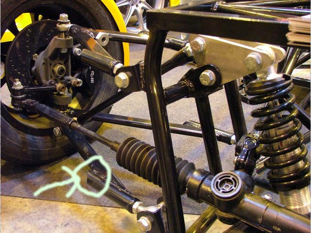

Just out of interest, has anyone got one a vortex through SVA? That front suspension looks like a new design and the adjustable wishbones look like they might present some form of sharp-edge problem?
I have no idea if they will or not, I'm just curious given the amount of fuss that's made over bolt heads and the viciously sharp edges that they have ;-)

Adjustable wishbones? My lower wishbone has bushes at the inner end and a balljoint at the outer end and so are not adjustable. the uppers have similar bushes and a transit track rod end. In this respect I believe that they are no dofferent to the locost design.
I wouldn't have thought that they would be any more of a problem than any other seven.

Matthew_1
posted on 20/6/05 at 09:54 PM Reply With Quote
I think I explained that badly! It's not the rose-joints that I was curious about, more the design of the actual wishbones.
Those wishbones have a pair of small tubes that the rose-joints screw into, I was just curious if the open end of each small tube presents an edge which mr SVA man will object to ?
Andy D's car has a different wishbone design which dosn't have the smaller tubes which the rose joints attach to, so no leading edge, so I'm not surprised it passed ok.
[Edited on 20/6/05 by Matthew_1]
Matthew_1
posted on 20/6/05 at 10:13 PM Reply With Quote
An image to explain it a bit better Rescued attachment stoneraceledainboard.jpg

marc n
posted on 21/6/05 at 07:25 AM Reply With Quote
it does look a little suspect to me as does this
would be suspect if it was properly fitted )
thats the loom cable tied in place before drilling and riveting ( this makes sure all the wires reach and go to the correct place ( also known as a dry build )
i will take some photos specially for you snoopy today just to reasure you
the tubes shown on the wishbones simply have nut covers placed in the ends glued which give the correct radius, sometimes they just fall off afterwards

the wishbones are a copy of a mod i did to some racecars we where runiing in the westfield championship about six years ago,
they finally allowed the use of rosejointed wishbones, but didnt make any ????, they then made some six months on and deamed ours illegal as they were not bought from westfield !!!!

sva cap
