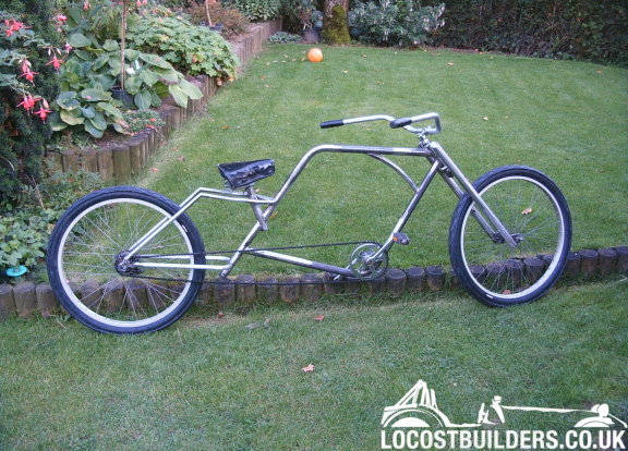

It seems that each large car manufacturer has a bicycle in their assortment to promote one of their models. Porche, Mercedes and Ferrari all have
them. So why not an “Locost bicycle”. After a weekend grinding and welding i came with this.
Greets, Roy

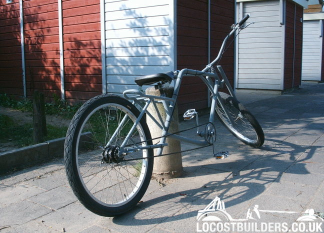

posted on 25/9/05 at 09:53 AM |
and another pic.

dr-fastlane
posted on 25/9/05 at 09:58 AM |
And the last one.

dr-fastlane
posted on 25/9/05 at 10:31 AM |
Hey Guinness, the bike is riding really smoot. You feel like riding an motorcycle and you don’t have to put much force to the pedals to come forward
rapidly. But the most fun thing is the response from people when they see you riding “That grazy machine”.
Greets, Roy.

JonBowden
posted on 25/9/05 at 11:13 AM |
Did you cut some bits off an old bike - eg pedal and steering bearings ?
Jon
Winston Todge
posted on 25/9/05 at 11:42 AM |
Awesome effort! How do the brakes work? Rear hub brake?
Chris.
dr-fastlane
posted on 25/9/05 at 02:53 PM |
JonBowden: The only bits that where cut from an old bike. Are the pedal an steering bearings like you say, and the little brackets that holds the
rearwheel.
Winston Todge: The rear wheel has an brakedrum and 3gear-hub.
The only things i had to buy where the special wide-flameprofile-tyres.
Here another photo when the frame work was half done.
greets, Roy

MikeRJ
posted on 25/9/05 at 06:53 PM |
That does look very
...but....
One thing that would worry me is how the front forks are attached to the head via those two tiny tubes which must be under a huge amount of tortional
stress. One bump could either make it a very "low" rider, or you could get speared by the pointy ends of the forks...
Probably just as well there's no brakes on the front...
niceperson709
posted on 25/9/05 at 11:59 PM |
you obviously had great fun making it but I not only worry about your steering head but also your section that holds the rear wheel is relying on the
strength of the joints for rigidity and will fail under stress loadings , you need a straight run from where the rear wheel mounts to the main frame
loop. remember triangles are stronger than other shapes.........
Best wishes IAIN
life is not the rehearsal , it's the show so don't sit there thinking about it DO IT NOW
http://iainseven.wordpress.com/
A3rd.Zero
posted on 26/9/05 at 02:21 AM |
assuming the welds are good, and from a distance they look good. and assuming you used left over pipe and not some fancy bike frame tubing then short
of an elephant riding that bike over woozels he'll never have any structural problems.
She's not heavy she's bicycle. Oh wait, she is heavy.

posted on 26/9/05 at 08:16 AM |
3 speed internal rear drum?
Is it a good old Sturmey Archer 3 speed hub? I would put some sort of idler/tensioner on the chain, it looks a bit long to be unsupported unless
it's as tight as a bowstring.

dr-fastlane
posted on 27/9/05 at 04:36 PM |
MikeRJ: Don’t worry about the two tiny tubes between the steering head and front forks. These are just like the rest of the frame made from heavy
construction steel and no thinly toilet-steel( such as we here in the Netherlands frequently say). Those little tubes are round 25x3 mm and the big
ones that holds the wheel are round 35x3.5 mm. But thanks for noticing.
Niceperson709: Building the bike was certainly great fun. And you’re right, triangles are stronger than other shapes. But the fun of building a bike
is to break all the rules, and build it like it isn’t possible. This frame is more stiffer and stronger than the donnor bike i used. But just like
MikeRJ thanks for noticing.
Peteff: Yesterday i looked at the wheel and it was indeed an Sturmey Archer 3 speed hub. Ten points for you my friend!!! The chain is a little bit
long. But is not really as tight as you think it is.
Greets Roy.
