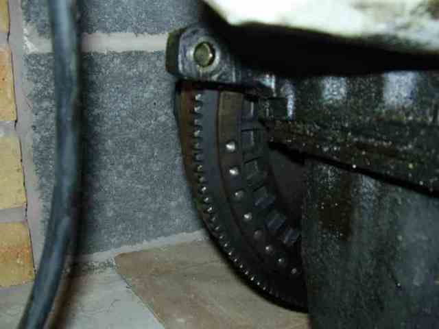

I have a 1.6 CFi CVH engine that I recently aquired for next to nothing, an intend using it for my Locost.
I have been playing email tennis with Bill Shurvinton about using a Megajolt and how it would integrate with the current Ford setup. Bill's
communication is faultless and quick. Its almost like he is sitting waiting for my next stupid email.
Seems I can use my existing coil pack/edis4/VR sensor AND the 'teeth' (see photo) cast into the back of my flywheel to feed the Megajolt.
Cost wise - £20 board & CPU, £100 Fully built and tested in a housing and £80 kit 'n' case unbuilt.
I have seen £35 as a cost of Megajolt on this forum and a website showing Avon + Pinto installation. Can I build one for £35 and where would I get the
necessaries?
Thanks, David.

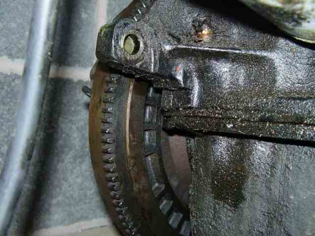

And here is the missing tooth.
