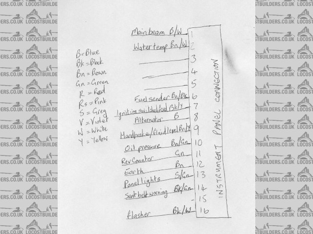

Northy
posted on 21/4/03 at 08:52 AM |
Cheers guys,
Do you have any notes on how you connected it up?
Graham

posted on 21/4/03 at 08:51 PM |
I've e-mailed a sketch of the connections I used to your virgin account. I'll attach it here as well.
yours, Pete.
![](/galpreviews/a34236-instrument panel.jpg) ![Rescued attachment instrument panel.jpg](/gallery/a34236-instrument panel.jpg) Rescued attachment instrument panel.jpg
Northy
posted on 21/4/03 at 08:55 PM |
Thaanks Pete, I've just mailed you
