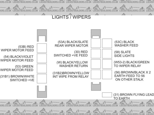

does anyone have the wiring diagram for sierra lights switch please
pritty please ?
also ignition if anyone has it to save me time with the meter

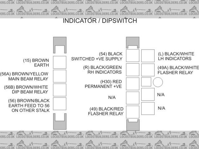

thanks just had a look at them both i see side lights but wheres the main beam and dip ?
I think you may have got the wrong pic
Sierra Stalk Switch diagram 1
