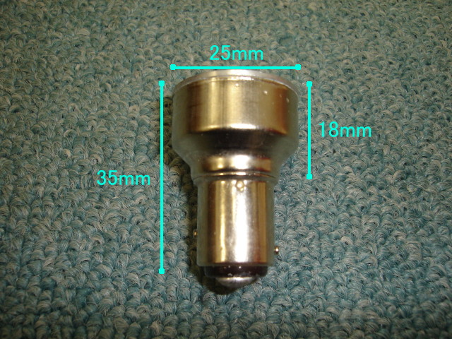

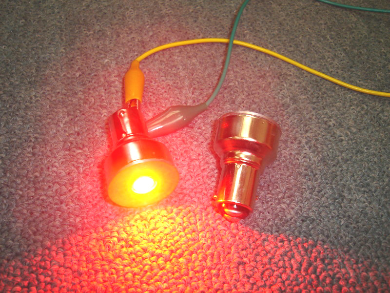

I received the samples from Hong Kong and have had a closer look at them today.
First impression is that they very well made with a purpose built aluminium casing, presumeably making them more damp proof and less prone to physical damage.
I used a BMW Mini indicator / parking light housing for my tests (which is what my project car uses). I inserted a Luxion ‘bulb’ into both sockets to get the maximum effect.
The new Luxion units give an incredibly bright beam (for an led anyway) which has a good 130 degree field of view but once again the lack of ‘backward’ light prevents the reflector from doing its job. As a result the lense of the light unit has an intense 20p sized dot of light directly in front of the ‘bulb’ and very little else. Maybe some kind of refracting cover which can point some of the light back would improve this issue but I am left feeling a bit disappointed once again. In my opinion the multi Luxeon version (which throws light in a 360 degree arc) produces a better light, utilising at least some of the reflector of the light unit. This new design is more suited to flashlight applications which require as much ‘forward’ light as possible, maybe even negating the need for a reflector at all.
Ah well, back to the old technology for a while longer.

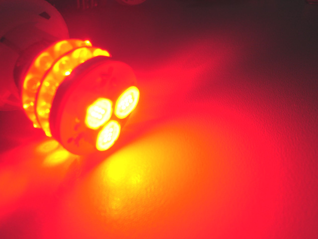

Just reviving this thread to point out that there is now a new model of LED 'bulb' available. It combines 3W Luxeon and side pointing conventional leds. This might be even better than the 3W versions which I have installed - I am waiting for some samples from the supplier to see how effective they are.
eBay Link
[Edited on 23-1-07 by RazMan]

I compared my Luxeon 'bulbs' with the conventional filament bulb and both are around the same brightness but the led is more of a blue/white light - the filament bulb actually looks yellow by comparison.
Not sure how you can determine wattage though and I suspect the regulation you mention refers to brightness more than wattage and I suppose terminology is a grey area here - the Luxeon is only 3 watts (power consumption) but is certainly a good equivalent in light output.
