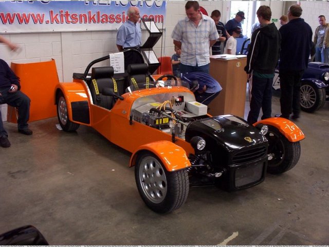

Anyone got any pics of the new electric MK?
Saw it on totalkitcar.com...
Just curious as to what motors they used and the drivetrain?
Chris.

I talked to the guy making the car at haseliers open days this summer. It was a project sponsored by his company to showcase the possebilities of electric drives. I think the engine had 90hp, they were suspecting the weight to be slightly high, about 700kg, due to the batteries in the back of course.
The main problem they were facing was the enormous torque the engine produced, think it was somwhere around 300Nm at 1RPM A torque limiter would come in handy.
The car was backed up completely by Haselier so it should be good quality. Dont know at what stage they're at right now though.
Some pics I took:

Heres some pics I took at the Dublin show Rescued attachment DUblin Kit Car Show 270806 - 009-1.jpg
StevenB
posted on 12/10/06 at 10:24 PM Reply With Quote

I'm working at the company that build this very funny Indy. We are the neighbours of Luc Haselier, the Dutch importer of MK. It is very nice to drive this car. No gears, no sound. Unfortunately the pleasure is gone after about 30km's, because the batteries run flat.
Drivetrain:
-28 x 12V motorcycle lead-acid batteries
-Siemens DC/AC invertor
-Siemens a-syncronious motor 50kW nominal / 80kW burst and 260Nm torque
-on board charger
-no gears, motor directly connected to the drive shaft.
Future:
-100 Li-Po batteries (quite expensive though)
-new invertor developed by ourselves
-same Siemens motor but now with around 60kW nominal / 100kW burst amd 260Nm torque
-battery management system developed by ourselves
Feel free to ask for more details.
