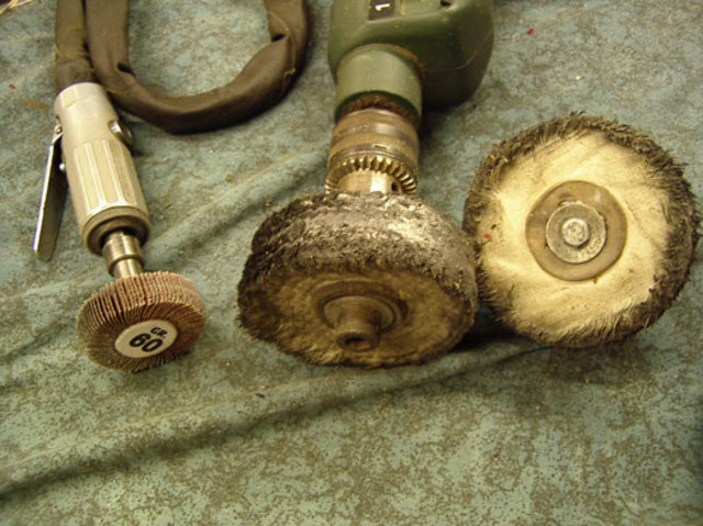

If it were aluminium it could be easily addressed. My question, TREV D are you out there, what is the best way of removing the suface damage to the stainless. All answers gratefully received.

posted on 15/2/07 at 10:20 PM Reply With Quote
In the absence of Saint Trev, may I suggest the following;
Flap wheel. Use like you would a sweeping brush,
bringing it down onto the metal, apply a little pressure, then lift off, keeping it moving all the time through each pass.
Don't attempt to dig into the mark or it will end up looking like a dent.
Try first on scrap.
Stitched rag wheel with soap, then un-stitched rag wheel.
If your s/s is mirror finish this should do it.
If you have a grained finish then use Scotch pad to bring it back to original.
Looks damn smart John. Well done.
Atb
