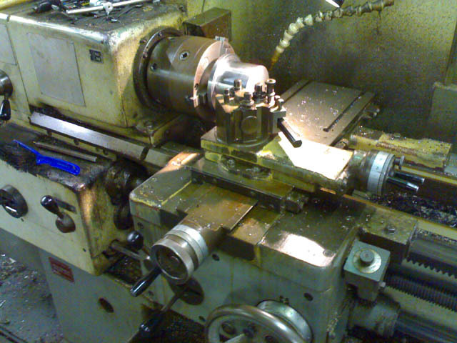

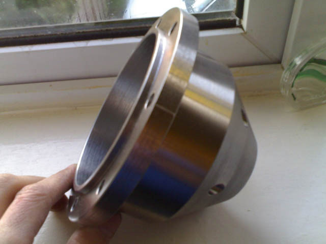

and its not all been fabrication, had a lot of late nights machining as well, made loads of bits, most time consuming being a pair of drive cups, which take the driven sprocket from each chain drive (1 per engine) and then have a 108mm CV joint recessed inside them to allow the use of a longer driveshaft (about 60mm longer than if the cv flange was outside the sprocket hub)
I'm quite proud of em, cost me £40 in 155mm dia EN16 billet and 2 and a bit evenings of machining!
