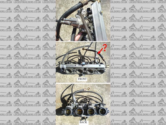

Hi, hope im not going away from your original question here, but i was just about to post a very similar question. Is it the bit ive highlighted in the photo? If so i was also going to ask what this bit did and if it was needed? I assume your runnning blackbird enginnes are you, ive just got the blackbird t/b's to go on an xe with megasquirt. Rescued attachment trottle bodys question.jpg

Blackbird Rush
posted on 10/4/07 at 08:31 AM Reply With Quote
Yep, Thats the bit i was takling about, its a cold start enrichment stat, allows extra air via small valves.

They are throttle bodies not carbs as I can see the top of the injector, that looks like the fuel pressure regulator.
andrew-theasby
posted on 10/4/07 at 11:26 AM Reply With Quote
No, the fuel pressure reg is on the end of the fuel rail.
MikeRJ
posted on 10/4/07 at 02:58 PM Reply With Quote
It is probably just a fast idle valve rather than doing any enriching. Mixture adjustment is normaly handled by the ECU in conjunction with the coolant temperature sensor.
If this is controled purely by coolant temperature it should be able to get it working with MS, but it will might cause some grief trying to get the cold start enrichment mapped
MS can control a solenoid type air bleed if full idle control is required.
