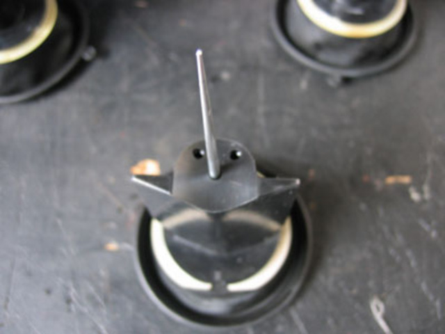

just fitting a dynojet kit and before I do something drastic just checking to see if i've got this right:
1 - I've swapped the needles to the dynojet ones and am supposed to block one of these air holes. does it matter which one?
r1 needle holes

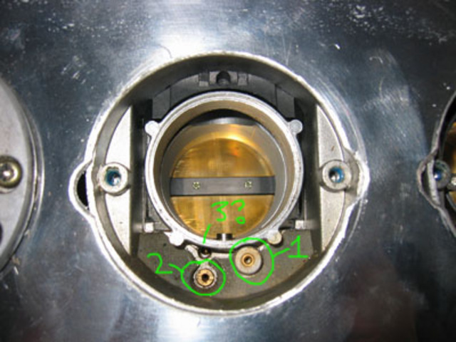

2 - Also got to block one of these.. im guess its #1 but just want to check.
r1 carb holes

It doesn't matter which hole on the slide you block.
It's hole number 1 that you have to block.
I can't think why you can't have a dynojet for SVA. There was plenty of adjustment on the idle screws for me. The main jet doesn't really affect a 2500 RPM idle and you could always lean off the needle if that was causing trouble.

1- Doesn't matter which one.
2- I would agree #1 the brass one that has no slot for a screwdriver that's the one I did! You could always give TTS a ring tue to double check!

is anyone 100% sure which hole has to be plugged in the pic below? anyone asked tts
r1 carb holes
r1 carb holes
It seems its hole 1 as said here

Hole no.1.
