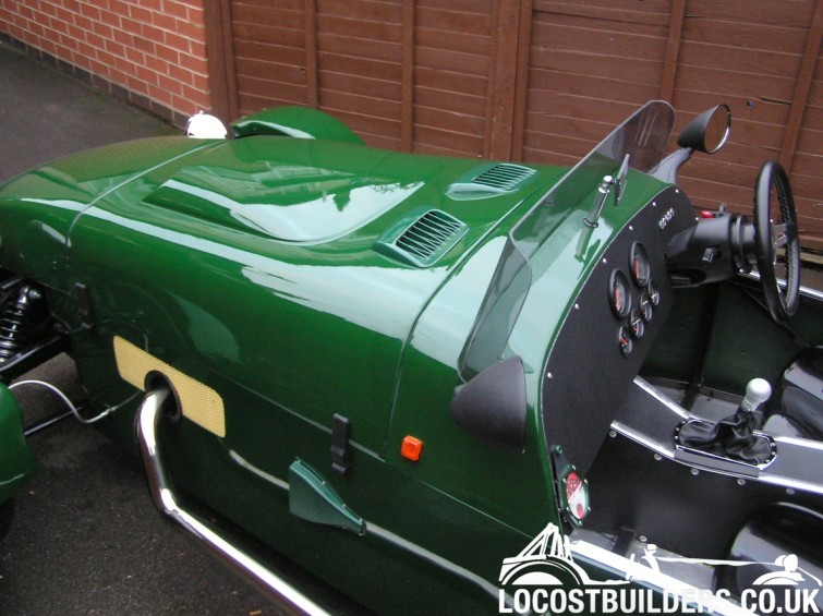

RK
posted on 17/10/07 at 10:27 PM Reply With Quote
I like this myself. This is what I'd like, if I ever get that far.
