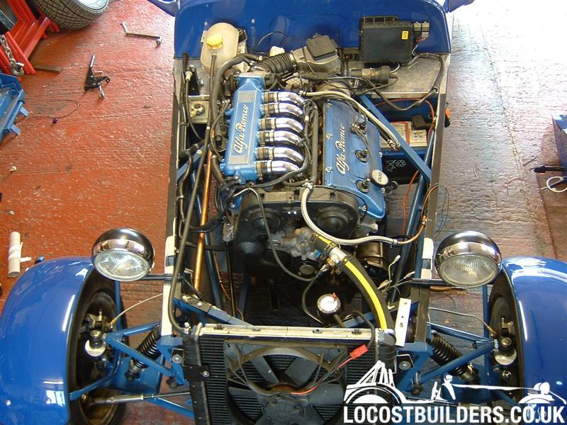

I have a Viento with an Alfa V6.
I used a rad from a volvo 740,
Fitted ok and seems to have plenty of cooling for my V6.
John
bonzoronnie
posted on 10/12/07 at 08:52 PM Reply With Quote
Engine bay
That is one impressive engine bay.
Ronnie
Mr Whippy
posted on 10/12/07 at 09:22 PM Reply With Quote
It's an impressive car, I say that having had a very close look once at Afford. Wouldn't mind a wee trip in it someday

sammy
posted on 10/12/07 at 10:18 PM Reply With Quote
That engine looks fantastic! Maybe if I use a volvo rad my RV8 will look as good? Maybe not...
Anyway, that does sound like a good option to try, I'm surprised that such a big car has such a relatively small radiator.

Johnmor
posted on 12/12/07 at 06:13 PM Reply With Quote
Thanks for the comments, If anything the engine bay is looking a little tidier now and I'm in the middle of altering the exhaust system
As for a trip, when the weather is better you are more than welcome.
John
