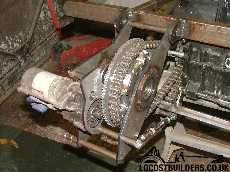

russbost
posted on 22/12/07 at 02:46 PM |
Nothing wrong with the idea, been done 1000's of times see below my Toyota MR2 diff with ZZR1100 engine, complete with electric reverse
[img]http://[/img]
Only thing I would say is that these installartions take up more length than you might think, you'll struggle to get the distance from the front
of the headers to the centreline of the diff much under 26", don't know how that dimension sits with the room behind a seven's seat,
might make for a very light front end too.
