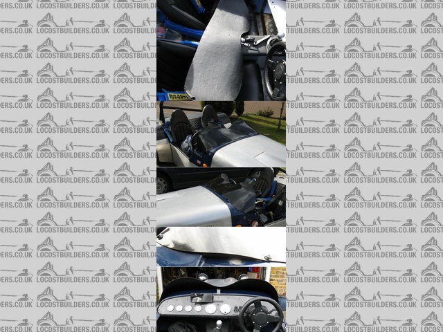

For those that have been asking, here are some pics of the new aeroscreen on my Stuart Taylor (the one with the lip/ledge on the scuttle).
I decided not to cut away the corners of the ledge in case sometime I decide to go for a normal screen again.
Fitting was fine - the screen is quite thin and flexible so you can bend it round to fit quite well. The ledge itself did not cause a problem height-wise.
Before anything else I sprayed the underside with some matt black paint to cover up a few whitish patches on the back of the screen.
I removed the old mirrors which had 2 fixing bolts - the screen covers up one hole anyway, and from the driver's seat I would not be able to see the passenger side mirror anyway, so I think I will get some F1 style mirrors and fix them just in front of the where I have got the side screen hinges.
I decided where I wanted it to go, then drilled the rearmost holes first and fixed it on using motorbike black anodised screen bolts (they come with plastic washers and a rubber nut affair, though I used normal Nylocs in the end). I then did the front centre bolt, then one at the front of each bulge, then the corner ones. On the ST scuttle the lip causes a bit of a gap at teh "corners", so I cut and superglued a piece of flexible rubber tube (cut off a tintop door trim) to block up the hole a bit. It still shows, so I might get some black silicone sealant and fill up the gaps.
The screen is quite flexible in the centre, so I made an L bracket from a piece of ali, fixed it behind the dash with one of the existing dash bolts, and used the final screen bolt to fix the screen on the top. As a final touch I superglued a piece of c/f (leftover from cutting the speedo hole in the dash) onto the facing of the bracket.
As you can see, the suction cup mirror is now stuck on the dash, so I might consider a pukka racing type mirror for the centre sometime. Also, you can still just see daylight frmo the back of the screen between bolting points, so I will probably fit some slimline rubber U trim on the leading edge at some point. I will rub down the filler in the old mirror holes and tidy it up too.
Side mirrors still to be purchased and fitted - I went out today on the motorway to the WLM meeting and I realised how much use I normally do make of the side mirrors.
I got the aeroscreen from tombob5 on ebay - £35 + £15 P&P - and it seems pretty good quality, A number of other locosters on here have them too.
If any ST owners want any more info on the scuttle fitting, drop me a U2U.

Cheers for the info Humbug. Looks like it fits alot better than I expected.
Me goes off to buy one :-D

Whats it like on the road ? Does it whip the airflow over your head ?

Looks good Simon, interesting to see that you have lifted the centre on the bracket where I have just laid mine flat on the scuttle, I presume thats due to the lip you have on the top of the scuttle?

Thanks for the comments... some answers from me:
1. Yes, the screen is raised up a bit because of the lip on the scuttle. I positioned it so it looked OK and fitted! I raised it up a small bit higher than necessary to clear the lip just so it wouldn't vibrate.
2. The airflow seems to hit me above eye level. Without goggles/helmet it misses my eyes so it's not too bad for short journeys. With a helmet there is some wind effect, i.e. the air runs down the front of the visor, but it is much better than with the mini screen - with that, the air went higher up, but seemed to curl down and go down the back of my neck.

Hi Humbug the aeroscreen looks really good they seem very popular for 35+
