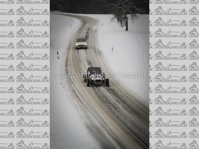

This is a piccy from last year's event. We're typically up against 911's, Volvo Amazons, MGB GTs etc. This is going to be interesting
and if I don't learn to properly catch a rear wheel slide, I guess I will never learn.

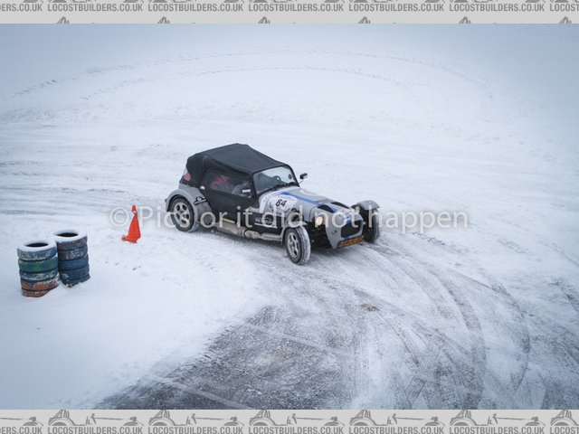

Right, a quick update. Today started out well with some driving tests on the Airfield I told you about yesterday. Lots of snow, lots of fun. We
actually started he day with the top down (for the pictures ;-)). After the airfield, we went en-route to the first timing check, where we arrived 5
mins late. Pretty good going I'd say as we stopped to pop the roof back up (a struggle at minus 8!) and for fuel. (Hello, cheap German fuel! This
still is locostbuilders of course!).
Soon after the first timing check we started our first ever regularity section. It was covered in snow and we were the 70th car on the stage. Slippery
does not begin to describe it! We very nearly put the car into a ditch but managed to somehow keep it on the road. Or where we thought the road should
be....

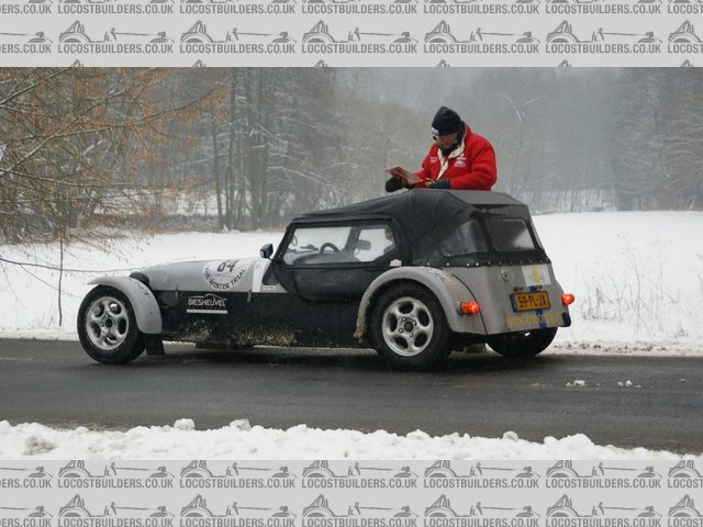

6 kilometres or so into the stage disaster struck. Broken clutch cable and no spare. With the tools I took with me I managed to shorten the outer
cable and prep everything for a successful reconnect. Only I did not bring the 7mm socket I needed. I tried for get by with some pliers but that was a
no-go. So we needed to wait for the service crew. Which took another half an hour. After losing some 2,5 hours in total we managed to get going again
and set of trying to reach the next TC in time. Which did not work. Thoroughly fed up for the day, we broke out the tomtom (yes, I know....) for the
remaining 250km. Quickest route was over the motorway which turned out to be fully snow covered with almost no traffic, so again VERY SLIPPERY. This
took almost 4 hours which was spent at between 60 an 80kph and mostly behind snowploughs(!), which made the light output at the front very, very low
because of the salt. We finally got to the hotel at 21:04 and when we parked the left wiper fell off..... That is now in the car and ill fix that
tomorrow.
