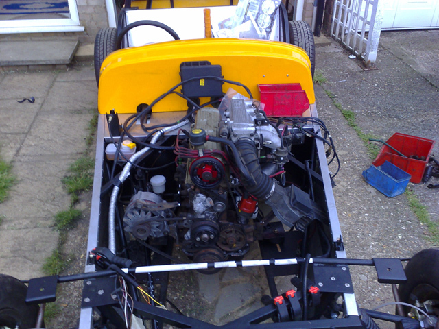

posted on 21/5/12 at 06:30 PM |
like this
![](/galpreviews/a184169-Cramped.jpg) ![Rescued attachment Cramped.jpg](/gallery/a184169-Cramped.jpg) Rescued attachment Cramped.jpg

quote: Originally posted by Autosri
i dont think it would make any difference which way the airflow meter is mounter as its just a heater element normaly
Wrong the airflow meter on a pinto is a moving flap with NO heater element. However, so long as it is roughly horizontal in operation does not really
matter. If anything upside down (with the black electronics cover uppermost) is/does make life easier, especially when it comes to recallibrating the
the spring mechanism.
And for those of you who do not know how to do it or why to do it. ..........
The allen key adjuster should normally only need to be screwed out a maximum of 6 turns to achieve a mixture reading of 0.50 - 1.50 on a CO machine.
With the adjuster screwed fully home you should get a maximum reading of 6.00
If the CO reading is high then (with the engine running) it is normally a simple matter of prising off the wedge shaped electrinics cover (held on
with silicone), then with the mixture adjuster screwed fully in/rich, slowly adjust the large toothed plastic wheel (by releasing its spring loaded
retaining pin) against the tension of the clock work spring until the CO reading comes down to 6.0 . Then when this figure is attained, unscrew the
mixture adjuster to give a reading of between 0.50 and 1.50 CO on the emisions analyser, finally refitting the cover with a bead of silicone
sealer.
JD.
oh and mine is running upside down at a slight downward angle.
Here we go, I knew I had a photo somewhere.
[Edited on 21/5/12 by jollygreengiant]
