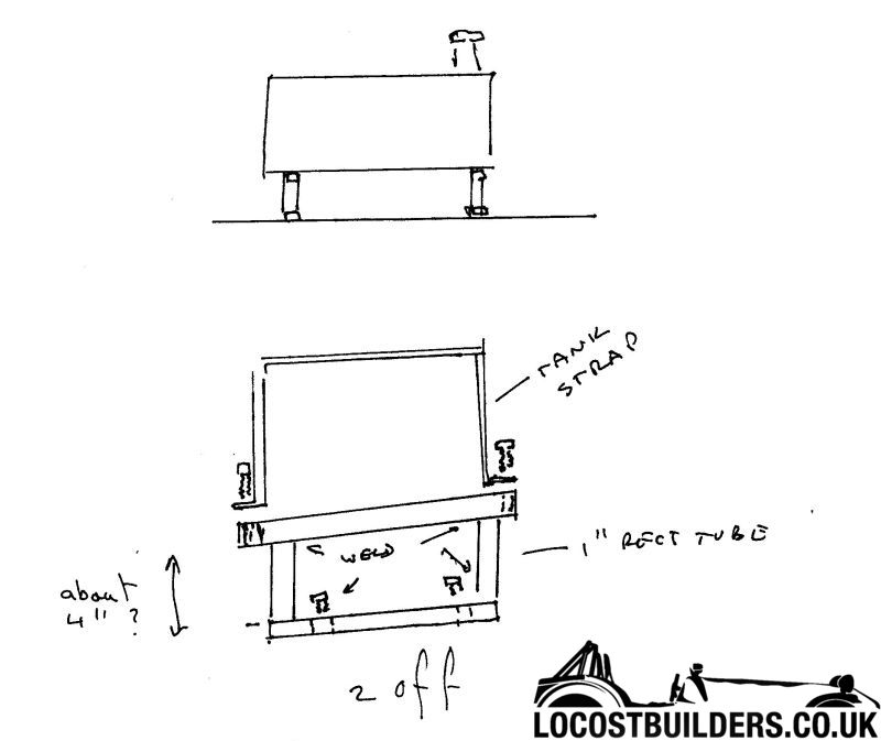

I made up a couple of rectangles from square section to raise the tank a few inches above the chassis rails. I'll try to find a pic.

something like this :-
The RHS tank strap does not go through the filler though

I'm only guessing now but I think you could mount the standoffs working from umderneath.
