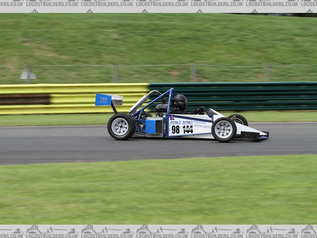

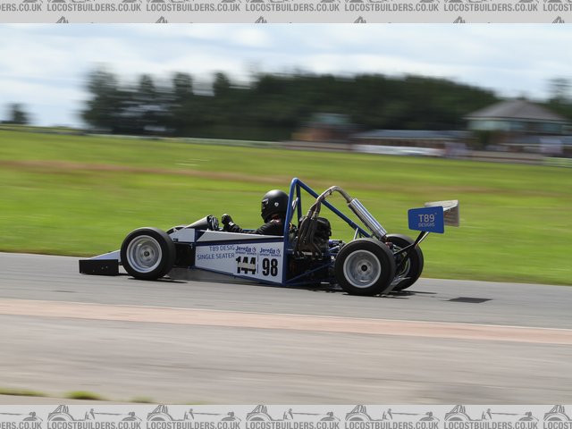

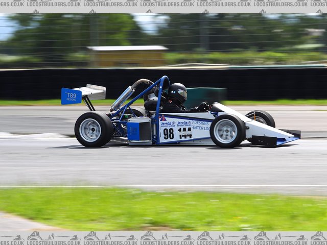

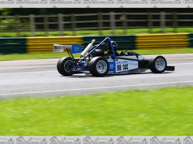

Doctor Derek Doctors
posted on 17/7/17 at 09:29 PM |
I thought I better book-end this project diary before I start a new one for a new car.
I didnt sell the car in the end, it was upgraded to the latest version (PH1.2), loads of weight reduction and performance parts and I have started
competing in it. It ruddy aweseme! Everything is was hoping it would be and massive fun.
