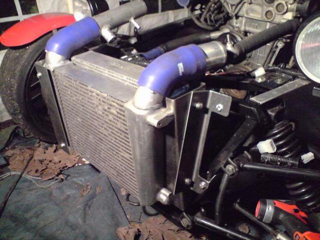

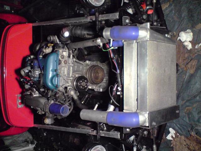

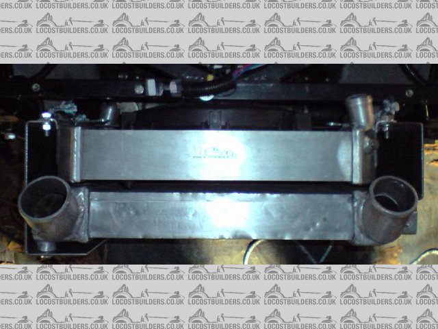

![](/galpreviews/engine and rad and inter.jpg) ![Description](/gallery/engine and rad and inter.jpg) Description
![](/galpreviews/rad and inter brackets.jpg) ![Description](/gallery/rad and inter brackets.jpg) Description
![](/galpreviews/intercooler and rad from above.jpg) ![Description](/gallery/intercooler and rad from above.jpg) Description
some pics of mine
