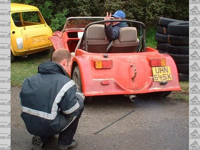

owelly
| posted on 6/10/17 at 03:11 PM |
It was this old tub......
  Magenta Sprint Teesside
  Steam powered???
http://www.ppcmag.co.uk
