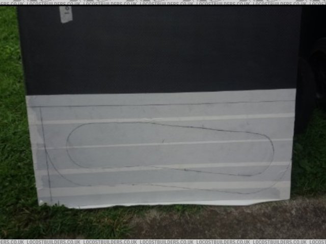

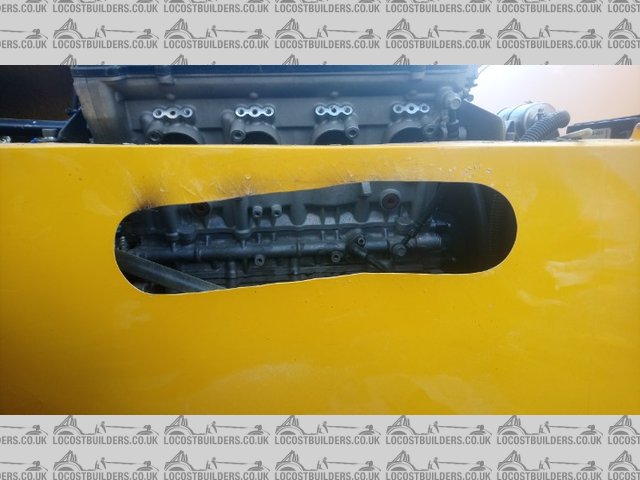

Exhaust System next.
Heat damage to the fibreglass where manifold leaves engine bay.
Carbon fiber purchase from Fibre-Lyte Stokesley for a very reasonable price.
Exhaust 1
Exhaust 1
Exhaust 2
Exhaust 2
Exhaust 3
Exhaust 3
Exhaust 4
Exhaust 4
Exhaust 5
Exhaust 5
Going to Wrap the manifold with exhaust heat wrap and upgrade silencer to Carbon Fiber. Will post photo's when completed.
madteg
posted on 9/10/17 at 09:45 PM Reply With Quote
Very nice
jrod
posted on 10/10/17 at 11:40 AM Reply With Quote
Great job on the exhaust trim.
CosKev3
posted on 10/10/17 at 03:36 PM Reply With Quote
Lovely car
As above,trim around cut out looks good.
Can't believe someone would do such a bodge job to start with though!

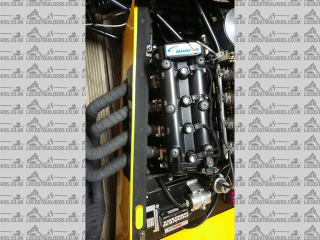

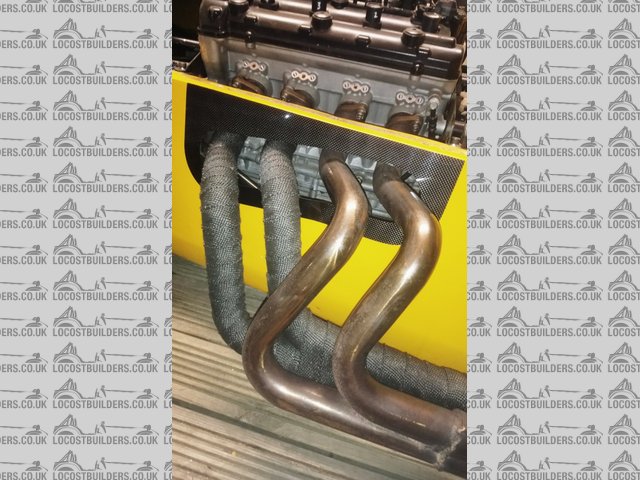

Finally had a spare morning to progress my exhaust.
Do you reckon the carbon can looks fine the way it is or would be better with stainless steel end caps fitted over the ends of the carbon?
Thoughts appreciated please...
Ian2812
posted on 11/2/18 at 05:30 PM Reply With Quote
Now exhaust completed, moving on to body work / engine bay tidy up.

Exhaust looks good,what have you done to the ends of the carbon cover,sealed it etc?
Ian2812
posted on 11/2/18 at 09:12 PM Reply With Quote
The ends are sealed with extreme high temp 'flue' sealant designed for log burner stoves. It's a nice tidy job, just think it would would look a bit better with some stainless end caps riveted on. Don't know where or if I I can buy them though. Again, advice / ideas welcomed by all.
