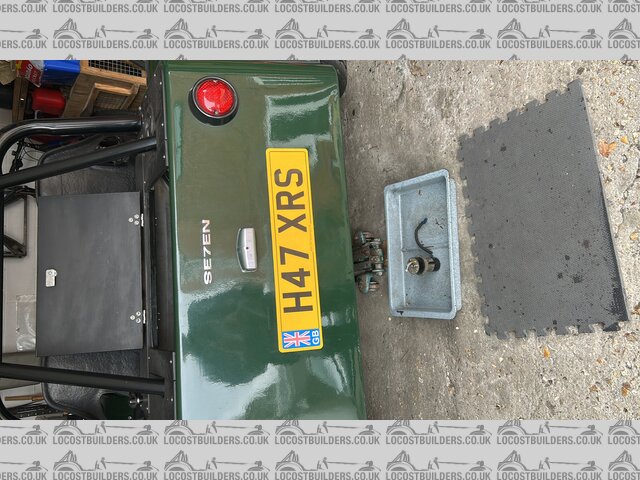

My car conked out when driving along country lane back in October, I thought I'd run out of fuel, but then realised I couldn't hear the fuel pump running! Called Autoaid, and got car towed 8 miles home, I had to pay an extra £25 as the car is over 10 yrs old, but was happy with the service and they came out within 1 hr.

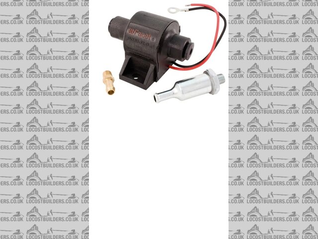

So the bike fuel pump I'd got from Bogg Bros 18 yrs ago with their re-conditioned bike carbs had failed, it had done 20,000 miles, so can't complain really. After contacting Bogg Bros, they said original replacement pumps are about £450 now! so they offered a Facet Posi-Flo fuel pump along with some 8mm hose barbs, & bobbins for £92 delivered. I also got a new a new filter and made a bracket from some ali angle/plate and used the old mounting holes. Fitted it all yesterday and now back up and running.

[img] fuel pump removed Oct 25
[/img]
[img] new fuel pump Nov 25
[/img]

Update: after taking the old pump apart, it seems like there is a set of contact points at the "dry" end to operate the solenoid and they needed a clean, so it's back together and working again now, wrapped up in plastic bag, so I'll keep it in the car as a spare.....
