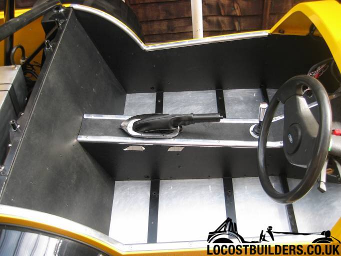

it sounds like the stuff we got from mk. its easy to bend to shape and fit the tunnel and panels etc

I used an ally extrusion from B&Q which is meant for edging flooring (I think). It's approx 25mm wide with a curved lip along one edge and a ridged face. It's dead easy to cut and bend along the tunnel and round the rear curve of the side panel. It wasn't too dear either!

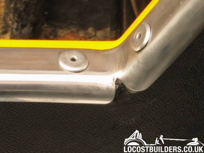

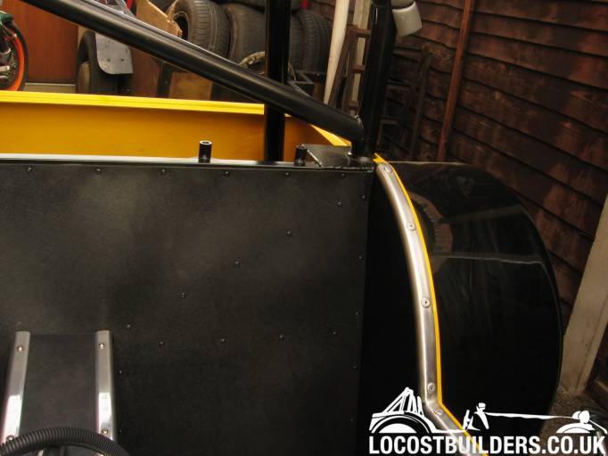

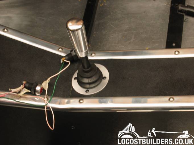

I had no special skills and managed to cobble these up from strips, had to nick it to get it to bend sharply by the wheelarch, but on the tunnel it was just a case of leaning on it over a sharp edge and a bit of tapping with a soft hammer.
The curves over the arches were started for me by MAC!, but I still did a bit of work, again leaning on it over a wheel and hiting it with a hammer till it fitted, then holding it real tight whist it was drilled and rivetted
