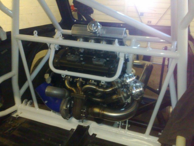

imp paul
posted on 12/6/13 at 05:54 AM |
morning all here is a pic of my engine for now just to give you some idea what its about
![](/galpreviews/small [800x600].jpg) ![zx12r turbo engine 2010](/gallery/small [800x600].jpg) zx12r turbo engine 2010
![](/galpreviews/24092009133 (Small).jpg) ![billet stacks](/gallery/24092009133 (Small).jpg) billet stacks
![](/galpreviews/CIMG1143 (Small).JPG) ![new gt35r twinscroll and tial](/gallery/CIMG1143 (Small).JPG) new gt35r twinscroll and tial
![](/galpreviews/20112009182 (Small).jpg) ![new plenum 2](/gallery/20112009182 (Small).jpg) new plenum 2
![](/galpreviews/19122009189 (Small).jpg) ![new parts so far](/gallery/19122009189 (Small).jpg) new parts so far

As I'm going to place the turbo low down I'm going to need a Scavange Pump
Performance Turbo Electric Oil Scavenge Pump Bronze Gear 12v 12 volts | eBay
Couple of other questions, does anyone know a cheap way of relocating the oil filter on the 12?
Also, will the injectors be be ok or will I need to upgrade? Are the standard injectors 330cc?
imp paul
posted on 12/6/13 at 01:50 PM |
The stock injectors are really flakey over 200 hp .stock 00/01 ZX12R injectors are between 310 & 330 cc/min.you could fit say some rc 550 but
peeps have ran with stock on low boost but not a good way to do the job .
as for moving the oil filter yes you can fit a sanwich plate but will need the correct thredded centre bolt eg this type of fitment
Mocal Sandwich Plate For M20 Filter 1/2 BSP Ports Oil Cooler Race Rally Track | eBay
also fit a beggi riseing rate fuel reg
and the stock clutch is going to poo it self so time to buy a propper job muzzys
