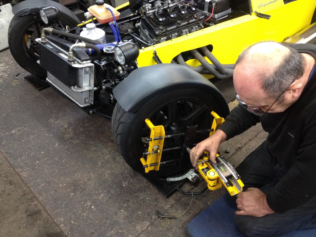

Been to ProComp in Birmingham and these guys are totally amazing, yet unassuming at the same time.
Upon arrival, I'll be honest, I was expecting gloss floors, high tech equipment and neon signs, reception area, coffee machine etc. To get to a residential address for my sat nav to say 'you have reached your destination' was quite a shock, I looked around then heard some roller doors being opened to reveal a concrete prefab garage at the side of a house. Never let this disappoint you, they need no gadgets, just their brains, knowledge & experience is all they need.
Ivan & Matt, father & son team - very welcoming, first off was a coffee... ahhh settled!
Firstly, they do not slag off MK like a lot of people say they do, they simply state the facts that's are not quite right with the chassis, but not just MK, just kit cars in general.
Never derogatory, just plain and simple terms, 'this is what we have to work with, this is how we are going to get the best from what we've got', exactly what I wanted to hear.
I got there around 10am, and left at 7pm, a long and cold day but my god I learnt so much and understood things as they really take the time to explain each aspect to you. It would be far far quicker and easier for them to ask you to drop of your car and leave it with them, but they don't want that, they want you to know what they're doing at every stage, and more importantly, why they're doing it.
For the money, I really don't think I could have spent that money any better, to think if it was the kind of glam place I was expecting, the price probably would have doubled if not trebled, they have it right, costs & overheads are relatively low. (i gather)
Can't recommend them enough, I just can't wait to get back on track again to really see the difference
So the treatment my car had was the usual:
Front camber, castor & tow
Rear camber, castor & tow
Rake & ride height
Chassis measurement check from datum
2x corner weightings, once before and once after geometry adjustments
Pro-Tech shock dyno'ing
Wheel bearing checked
Tyre pressures corrected (oops)
Positive camber in roll issue rectified

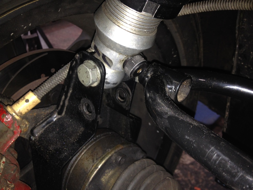

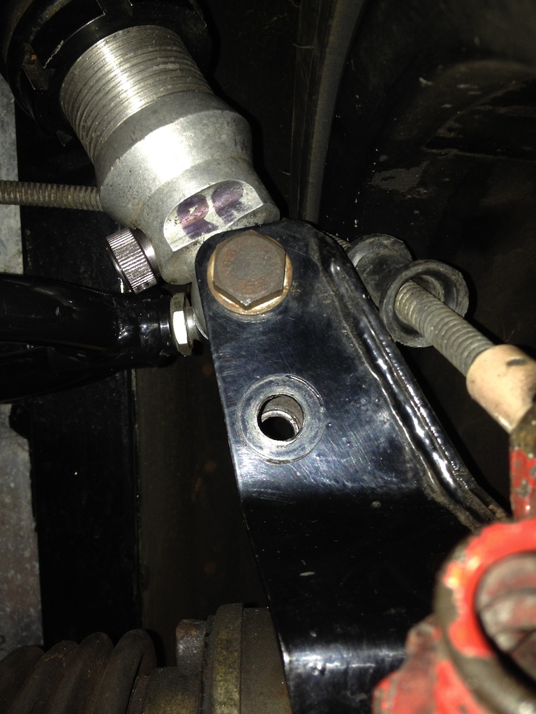

As I had rosejointed the rear arms on my MK Indy, it enabled us to move the rear upper wishbone outer mounting point upwards along side the bottom shock absorber bolt, which significantly reduced the amount of positive camber movement when in roll.
In it's standard position, when in 1degree of roll, I think we calculated that that calculated to 1.2degrees in positive movement (it did not move to +1.2degrees, it just moved in a positive direction by 1.2degrees)
After we had moved the upper wishbone outer rose joint up alongside the bottom shock absorber bolt on the upright, it now reduced the amount of movement from +1.2degrees, down to +0.4 degrees in a positive direction.
Obviously this is still not perfect, we would not like any 'positive' movement in camber when in roll, however, as above - for a very simple move, this is the best we can get without having to grind, cut, move, and re-weld bracketry & shock absorber mounting points.
As my new static rear camber is -1.5degrees, when in roll, the outer rear wheel will now still have and remain in negative camber by 1.1degree.

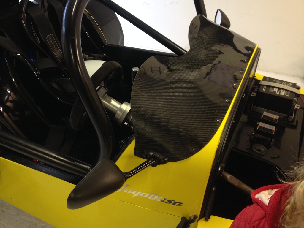

Wing mirrors on the car have always been useless, as all you can see is the rear tubs, so I went about moving them high up onto the cage
This is where they were originally, mounted on the side of the scuttle
Oh, my little Miss Stig jumped in when I wasn't looking
Drilled & tapped the cage, rather thick metal, possibly about 2.4mm walls?

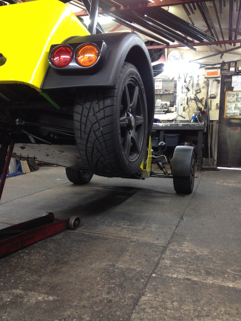

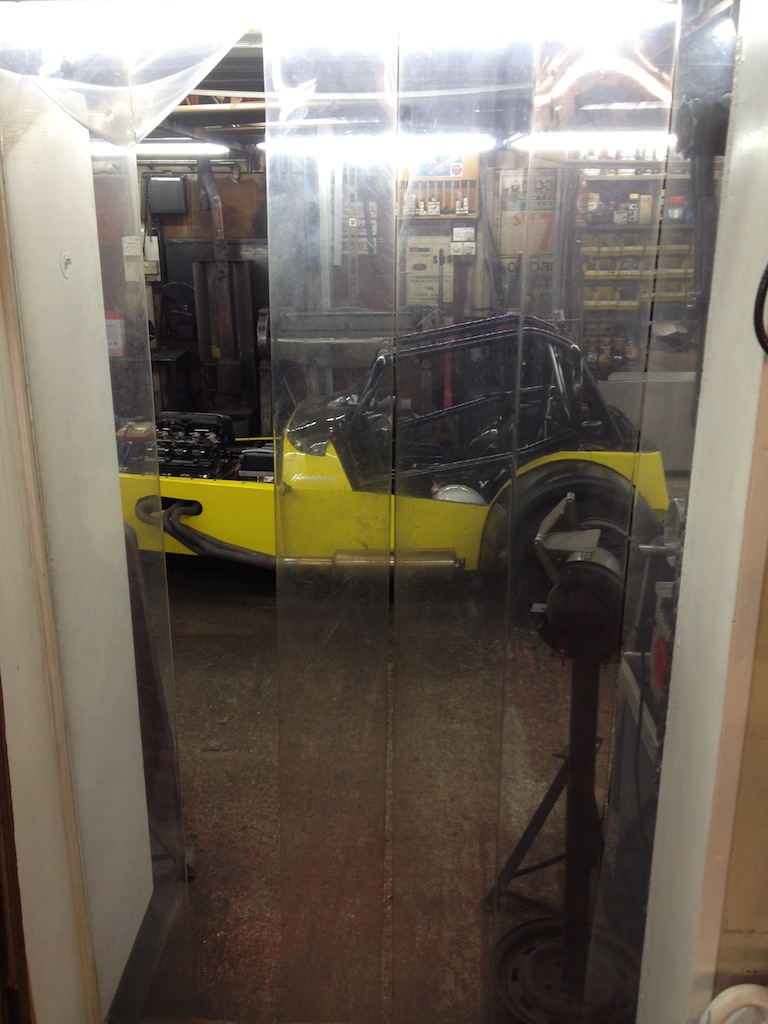

Then off to ProComp, not a great deal of photos taken, I was too busy listening to their advice and trying to remember it all...
But there are a couple:

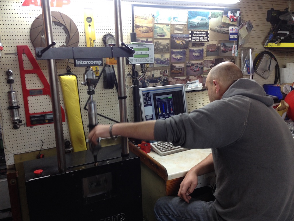

Mat dyno'ing my shock absorbers
Ivan tinkering with tyre pressures I think
More tinkerage

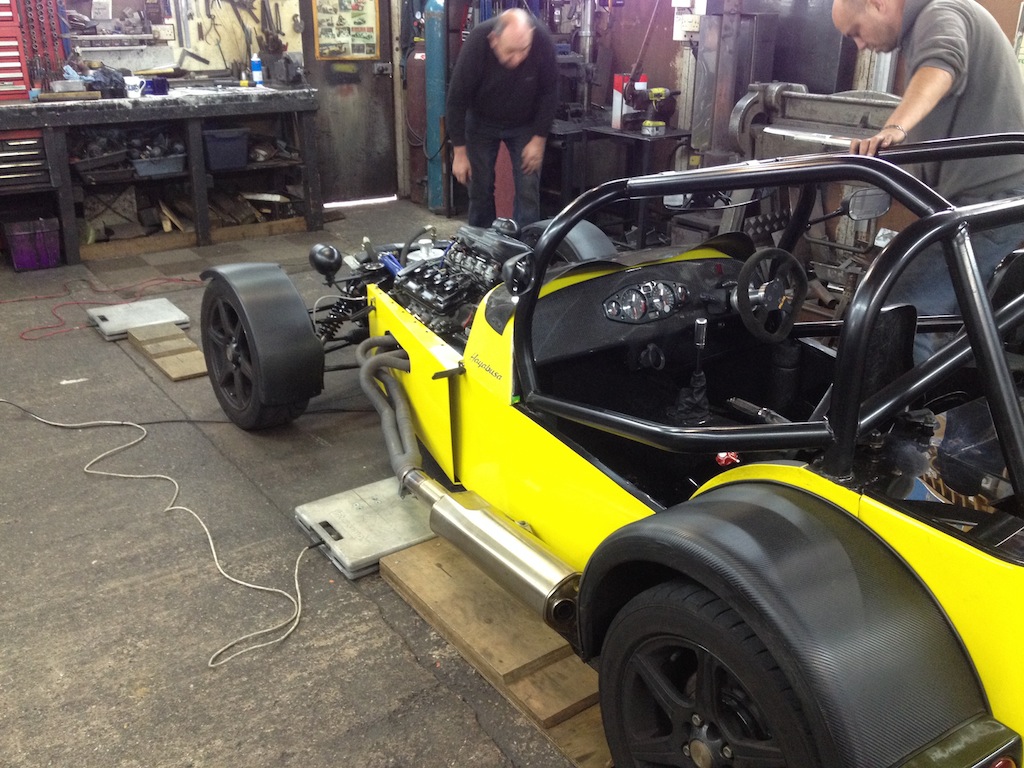

Corner weighting

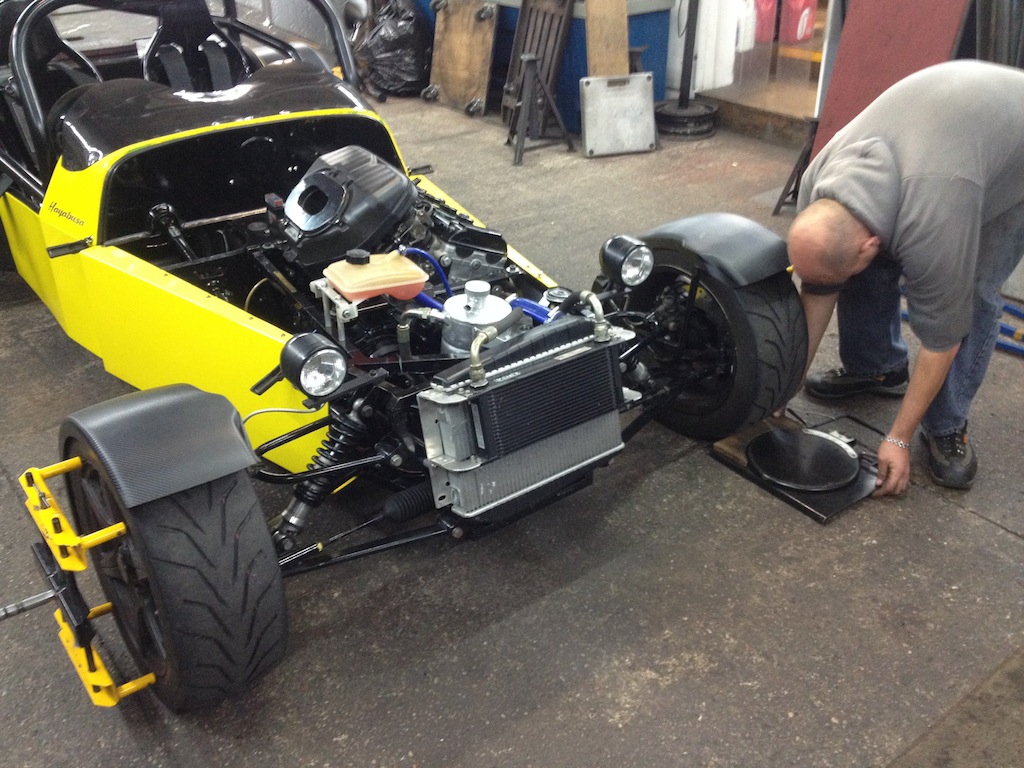

Tracking & castor measurements
Rear upper wishbone mounted up alongside the shock absorber inside the original upright
Weight:

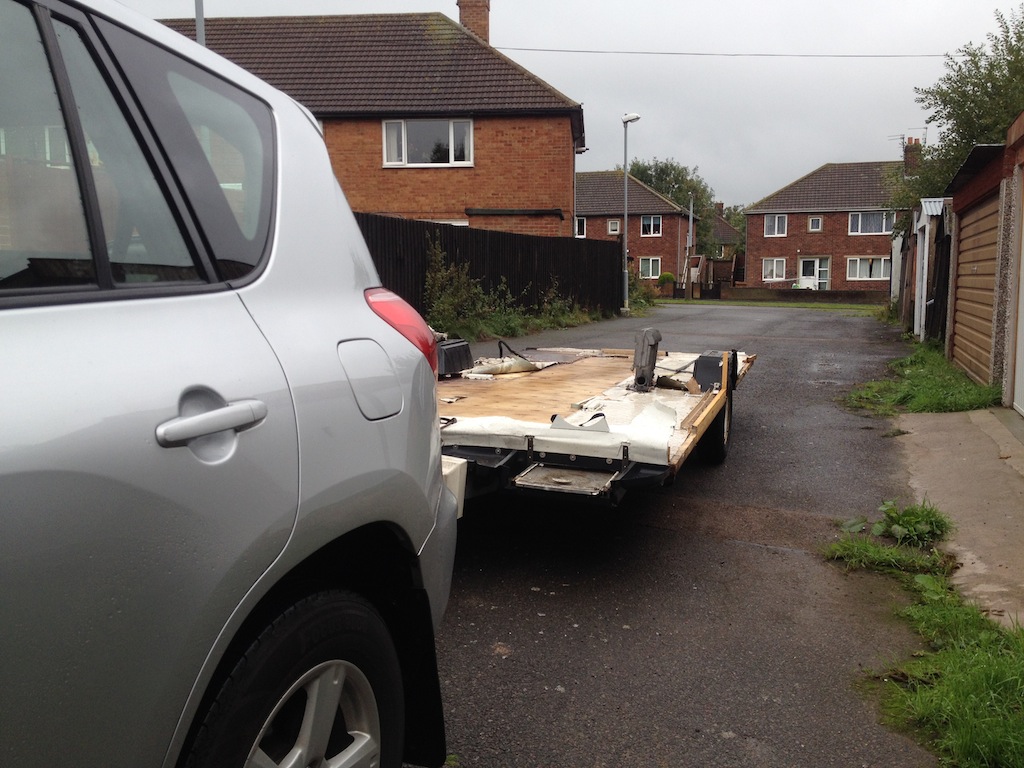

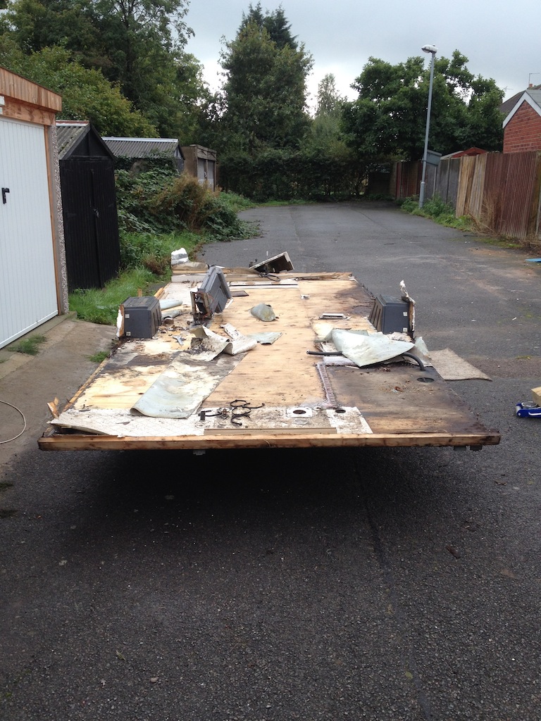

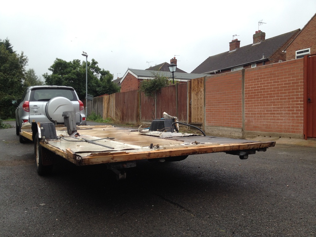

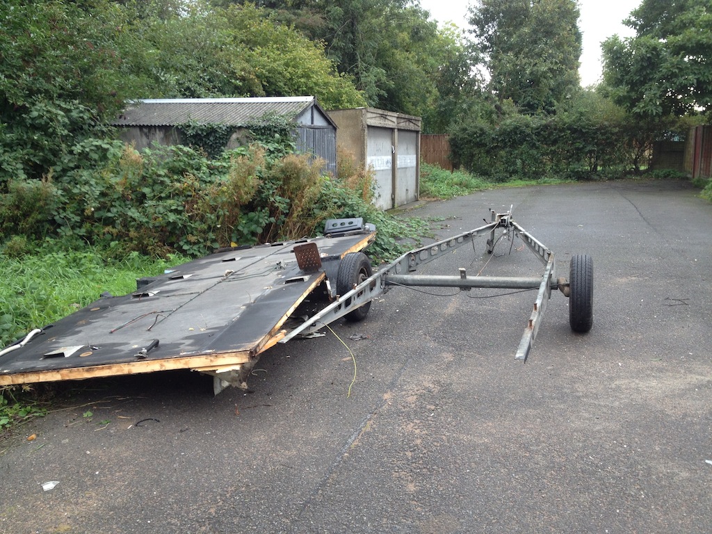

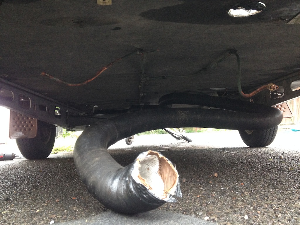

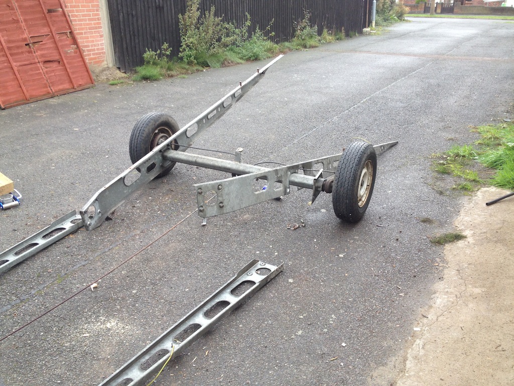

Decided I really need a trailer in order to enjoy my car at further afield trackdays - so I bought an Alko galvanised caravan chassis this morning, which looked a right state.
Huge thanks to Colin/ReMan for helping me getting it back home, and thanks to cosmick for finding it for me!
Colin and I looking like pikeys trying not to get pulled over
All set for shortening/ customising and making it look pretty

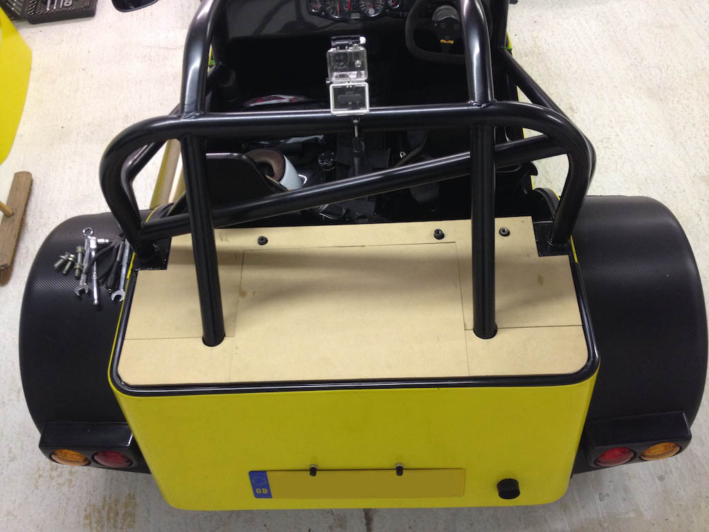

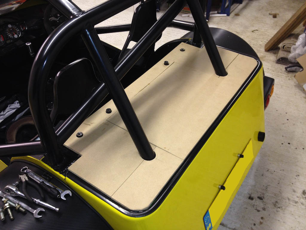

In the process of making my rear bootlid a little neater as its currently shocking
This is a rather thick MDF version but not as heavy as it looks, but more than likely will be replaced with ally at a later date
