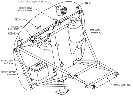

You’ll notice in the several pictures that the [typical] 4 mounting points are mounted outboard as far as practical on the bulkhead very near the
skin. What you don’t see is any reinforcement or backup structure that might (or should) be included.
What I did find while looking for pics though was very enlightening and apropos, I ran across this Vans aircraft safety bulletin. It was interesting
to say the least:
http://www.vansaircraft.com/pdf/sb08-6-1.pdf
Pages 5 and 7-10 are particularly helpful in demonstrating what I’m talking about. What we have here is a woefully inadequate design that they fix by
slapping on a doubler. First, the problem occurred for the exact reasons I was mentioning; which is load was being dumped (reacted) by flat-plate
bending in the bulkhead. This is a terrible load path to begin with and it really, IMO, should be backed up by a little angle fitting in the corner
behind the bulkhead. A tension fitting would receive the load from the engine mount and then pass it along to the outer skins. It would weigh mere
ounces and the design would be far more robust. You can fix it the way they did, but I don’t think they are making it a particularly robust design
that way and they are likely to have problems with it in the future. I’ve always fancied the idea of building a plane and generally Vans has a decent
reputation, but after seeing these photos, I’d take a HARD look at the one I wanted to build before making that leap (unfortunately not many buyers
are going to have the technical expertise to evaluate the structural integrity of what they are buying and will rely on the manufacturer to do that
for them…).
The whole problem would have been avoided in the first place had they properly backed up the attachment (i.e. their ‘hard-point’ was actually a hard
point!) like I was yammering on about in the earlier posts. This also demonstrates what I was saying about even professionals (at at least people
professing to be such) fairly frequently have trouble executing.

Now here is a nice looking engine attach:
http://www.flycorvair.com/jan04601h.jpg
right out to the edge (where the skin can get the load and where the bulkhead won't get the crap knocked out of it. Also note the overlapping
stiffeners make a natural spot for the load to be dumped into (guess I'll have to take another look at that Zenair).
