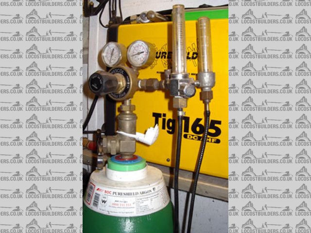

On the subject of regulators I prefer to use a flow meter (or two).
They are so much more accurate than the flow gauge on a regulator, down to the last 1/2 litre / min. It can save money on gas! (I'm a tight
git)
Paul G
