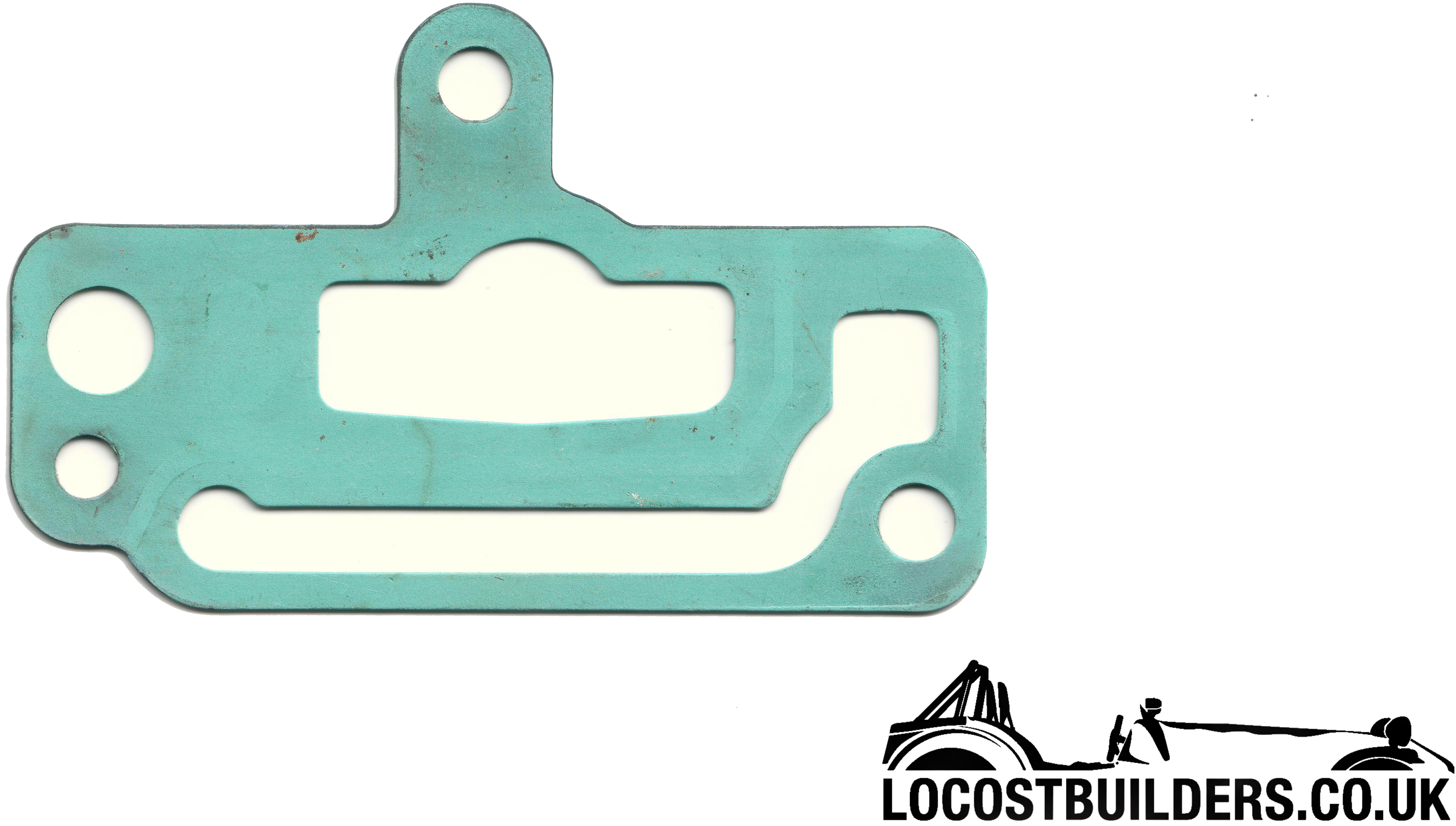

posted on 25/8/09 at 10:06 PM Reply With Quote
this is the bit i've taken off, its gasket is about 14cm across, 5cm tall. the hole in the water jacket is only about 25mm diameter.
my pc seems to have something against opening photoshop AND ms paint, i was going to put up a photo of the gasket, but i can't at the minute
i can do this one, where you see a bit of the round piece where the sensor goes
http://www.locostbuilders.co.uk/upload/4Untitled-1%20copy.jpg
yeah the photos huge, but resizing is out of action right now... bear in mind the dimentions above
the passage below is something to do with the exhaust gas recirculation i think, which i'm doing away with as i'm running carbs. so the opening in the water way is tiny compared to the size of the plate

That looks like the EGR valve holes to me..so it'll be exhaust gasses on one hole and the inlet manifold vac on the other.
X20XEV lump?

sure is. but blanking them all off.
3mm ali? not arguing, but seemed a bit thin to me. could always go a little thicker to please myself, 5mm, then see how that goes i guess

Why not try the Omega/Vectra fix method? They use a coke can, with the original valve to hold it down. Chop the top off that, use the coke can and Robert is...you know.
Long live RWD...
posted on 26/8/09 at 10:36 PM Reply With Quote
^ erm, not entirely sure what you mean, but the whole thing has to come off as i've got about 2" space behind the engine before the bulkhead. so it'll need to be a waterjet plate. thanks for the suggestion though
