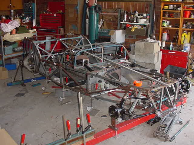

posted on 30/11/10 at 02:08 AM Reply With Quote
Originally posted by oadamo
if i was to build a new chassis not a locost one but to my own design to suit the bodywork iam thinking of making, but then ty to iva it what are the requirements. do they test the flex or strength or do you need to supply drawing because its a one off.
adam
What, you mean something like this ?
Not in the UK, but done here in Australia
