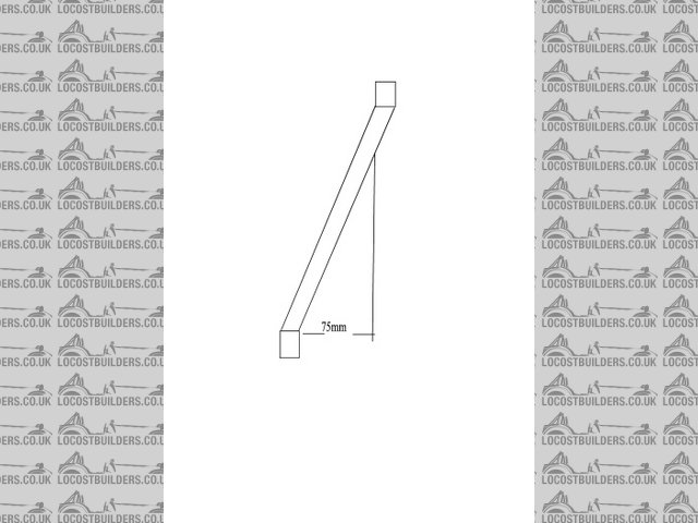

leto
| posted on 29/8/04 at 04:44 PM |
We used this template to get it right.
LC and LD were fitted before LA and LB
[Edited on 04-8-29 by leto]
