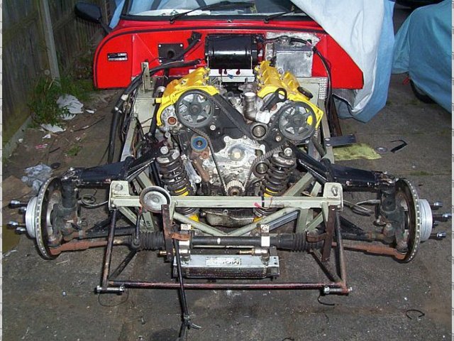

The front corners are definitely a weak point - I found both side of mine to be cracked right where they join the upright !
I added four tubes in a `W' - seen here on another V6 Fury I did .

FuryRebuild
| posted on 30/6/12 at 03:56 PM |
That's a good looking v6. I don't recognise it.
And thanks for digging the photo out.
I like the design of the top left gusset in this picture - if it works out to be a similar weight (or less) to cross bracing the front with tubes, I
may cut my single tube out and cad and cut one like this.

clairetoo
| posted on 30/6/12 at 04:14 PM |
Thats a Mazda KL V6 - same as in mine
I'm not keen on gussets in place of tubes - a gusset has no compression strength at all , and will be limited in shape by other components - the
central `V' in that chassis is set back at the bottom (to pass the rack mounts , which are allso welded to the tubes)
I found a better picture as well

DIY Si
| posted on 30/6/12 at 08:39 PM |
Ah, now I see a pic of what you're thinking of, I'd go with Claire and use tube. Gussets are only of use to strengthen joints rather than
to replace tubes themselves. And the tubes will be much stiffer, and about the same to fabricate and fit.
