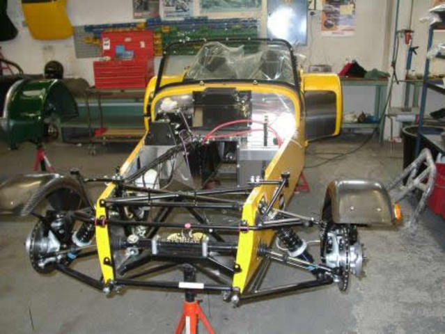

| posted on 15/9/04 at 03:30 PM |
Looks like the front mount is in single shear in front of the chassis section. Picture borrowed fron R500 site.
