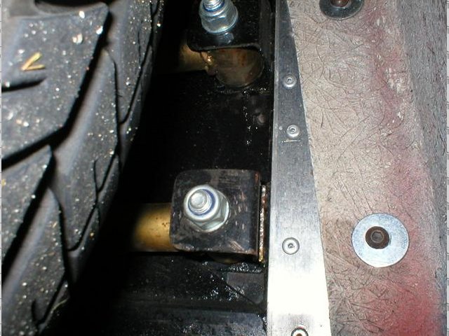

Just something to bare in mind when you are making your suspension brackets for the rear.
the way the drag links attatch to the chassis, isnt very strong as i have found out, my bottom brackets have split, the weld has held
Thats only around 800 miles worth of driving

This was an original problem that was documented.
If brackets already fitted, then a small brace forwards to vertical rail would stop this happening.
If just making the chassis, it was then suggested that a piece of box section full length of two brackets with one side cutout was better.

Rob Lane
| posted on 27/9/04 at 03:06 PM |
Yep thats the big square section.
To modify what you already have just cut a small square of 3 or 4mm flat and weld on like pic.
(Sorry for hijack of pic)
You will ned to cut ali and wing slightly to accomodate.

Mark Allanson
| posted on 27/9/04 at 05:21 PM |
I heard about the problem very early on, luckily before I finialised my rear chassis
| posted on 27/9/04 at 05:39 PM |
Put the trailing arm bolts in the other way round Mark
or you'll have to take the seats out if you ever want to get to the front bushes.

| posted on 27/9/04 at 10:16 PM |
Also stops the threads becoming bunged up with road muck.
