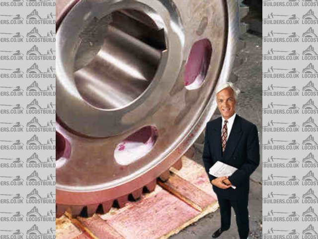

stephen_gusterson
| posted on 11/10/04 at 07:15 PM |
as proof of James's dimensional misunderstanding problems, I thought Id post a piccy of the gears that James had rejected from McClaren
atb
steve

James
| posted on 11/10/04 at 07:46 PM |
They look about right to me!
You're just showing them out of scale!
One can clearly see the wooden bases they are on are made from matchsticks.
James

| posted on 11/10/04 at 08:29 PM |
As for those gears
It was all a decimal point mixup.

stephen_gusterson
| posted on 11/10/04 at 09:57 PM |
not a fake pic
http://www.keller-getriebe.de/service2.htm
