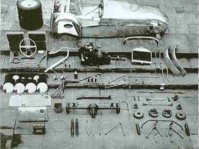

Macbeast
| posted on 13/7/13 at 08:58 AM |
Oh God ! Please let it be an original Chapman Lotus 7! Please !
[img]
  Lotus 7 kit
[/img]
[Edited on 13/7/13 by Macbeast]
