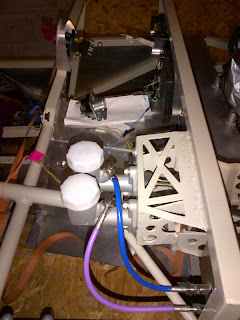

mark chandler
| posted on 18/7/13 at 06:43 AM |
I'd say personal preference.
I made mine hung from the top bulkhead tube
  Steering and pedals 12 Feb 06
Not that clear in this picture, holes in the pedal arms have welded tubes, effectively made from off cuts but have served me well.
Regards Mark
