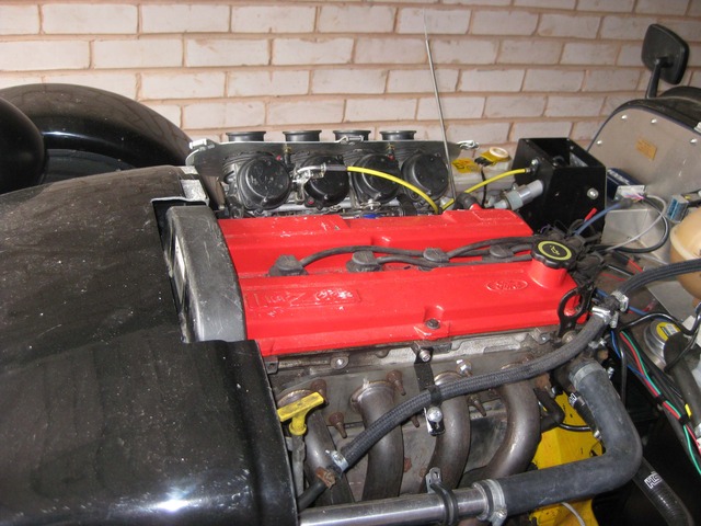

Yeah - I built an early MK-chassis-ed Locost. If you choose a Zetec engine, no doubt you'll couple it with a Ford T9 box. This will limit how far back you'll be able to mount the engine. I had to keep 10mm gap between the bell-housing rear face (back end of starter motor housing), and the
chassis bulkhead.
Bell_housing_Clearance
The Zetec is taller than the crossflow (which I had originally installed), and seems to be longer. The end result was that I had to form a cut-out in the rear edge of my nose-cone. Some form of bonnet bulge will be required - still on my ever-lengthening "to-do" list. I recommend that you check for installation space at this chassis stage, so that you can make the necessary mods well before the build stage.
