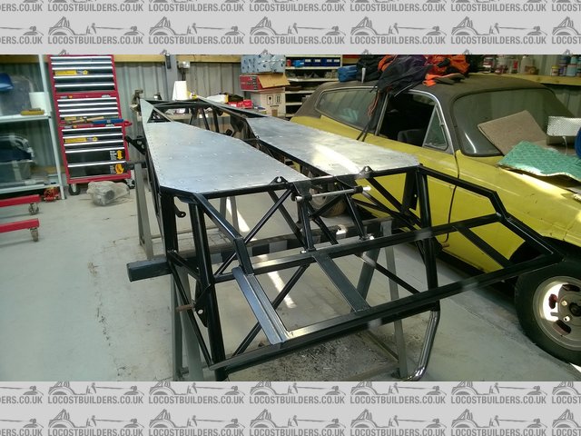

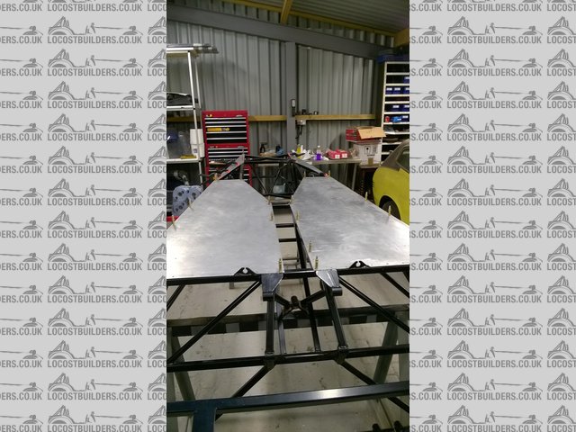

| posted on 1/11/21 at 12:54 PM |
^^^ keying the bond area is still a good idea
you only need to remove the paint / coating up the centre of the where the PU is going to go (I needed a flap wheel as my powder coat was really well
stuck on ) the idea being that the adhesive should squish out a little and overlap with the remaining powdercoat / paint to seal it all up - no
touch up required if your careful
also keying the alloy or GRP panels - again just rough them up in the area where the glue will be only (I test fitted the panels then scribed lines
round the edges of the tubes to keep it neat - then just be careful with the course emery paper)
this way the PU is probably doing most of the actual work - the rivets are probably just clamping it while the adhesive cures (but they do also
provide a good secondary mechanical fixing just encase)
also if you are comparing different PU adhesives you'll see that some are much stiffer when cured than others:
the Wurth bond & seal stuff I linked to above is great for high strength and pretty stiff too - its similar properties to Sikaflex221
something like tiger seal is much softer and weaker, but good for bonding in brittle things like glass (also harder to find any proper data on as its
more of a consumer product than the others)
don't take that to mean I don't also have rivets in mine though.... 've just got a few
  compulsory floor panel pic
  my new favourite tool
  floor on !
