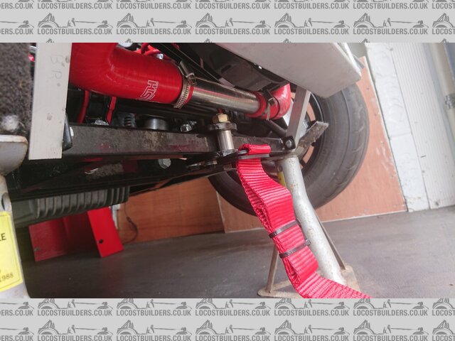

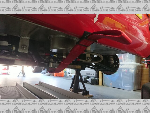

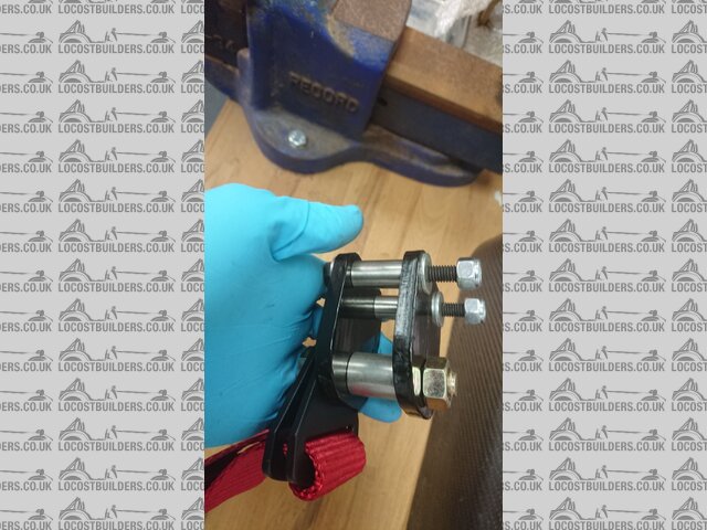

Not sure if this helps but it might give you some ideas. I made up a pair of these clamps out of thick steel with high grade bolts (because I had them). The stainless sleeves are a little smaller than the chassis rails.
Clamp
Clamp
The are clamped tight on the front and rear chassis rails with the straps held up out the way by heavy duty velcro. When needed a quick pull releases them ready to use.
Front
Front
Front
Rear
Rear
Rear
There are more pictures in my photo archive on here.
They have not been used in real anger yet but I can pull the car quite happily with a climbing sling through them.
The velcro is now multiple track days and a season sprinting old with zero issue. It keeps the straps put of the way very well.

Tidy solution and avoids having to weld to an already painted/powder coated chassis.
