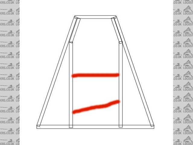

Gav
| posted on 18/2/06 at 10:55 PM |
OK here is an extremly poor, beer fueled diagram of what i mean.
I would have to measure tomorrow to show the exact position of the tubes, but they are meant to be pretty equal although
id expect the bottom left tube would not be quite as equal as the right hand side as this is where my problem lies with clearance.
The front two tubes could all the way back to almost halfway of the bottom off this section i think.
[Edited on 18/2/06 by Gav]

mark chandler
| posted on 19/2/06 at 10:33 AM |
Better if all the pipe ends join, it does not have to be symetrical so you should be able to achieve this on the off side at a minimum.
Drop the engine where you want it and build around, Just make bigger triangles !
The lower front wishbones are braced by G1 & G2 so you will want to beef it up at the front corners.

C10CoryM
| posted on 19/2/06 at 05:19 PM |
Well, personally I dont like the before or the after .
The locost is supposed to be a space frame/backbone chassis. I would call it a 4 bar/backbone chassis because to be a space frame it must be properly
triangulated. In all fairness, engine bays and cockpits are always hard to triangulate correctly and the locost was not intended to be perfect.
For example the book chassis tubes G1/2 join C in the middle. This introduces a beaming force into C. G1/2 "should" go to the corner of
C/M and C/I. That rids the beaming load in C but still doesnt triangulate the engine bay. Triangulate means triangles. Anytime you see something
other than a triangle its not good.
For the after drawing, your new tubes must join on tube F and have a 3rd tube going across from that junction. Otherwise you will put
beaming/twisting forces into F. You usually have to get creative to get around the oil pan. What you should do is make a drawing of where your
oilpan and anything else that hangs down in between the lower rails are. Then maybe we can give you some idea on how to clear it and keep the engine
bay stiff(ish ).

Liam
| posted on 19/2/06 at 06:30 PM |
The 'after' is definately not a good idea! Especially if the top of the engine bay is like that too. The front and back parts are stiff,
which only makes it worse for th etotally untriangulated middle section that is free to parallelogram all over the place. The stress on the joins
ringed on my diagram would be horrendous!
Cymtriks analysis will tell you that removing the top R tubes and replacing them with two short tubes to the middle of the outer tubes is bad enough
for strength/stiffness. Doing it to the bottom of the engine bay too would be dangerous imho unless the outer tubes were all significantly
uprated.
Much better would be something like my bottom diagram. You shouldn't need to remove both G tubes for the blade oil filter, and more clearance
could be obtained on one side with a y-brace as shown.
Liam
Gav
| posted on 19/2/06 at 07:34 PM |
Interesting! thanks for the input.
This mod is only a nice to have. right now i can place the engine in ok, its just id like a little more clearance on that side for the pipe work and
to put a little more distance between the tube and the oil filter.
After taking all that in, i think the best solution would be to go with Liam's idea of a Y brace.
