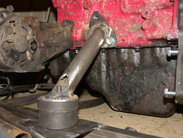

DIY Si
posted on 13/5/06 at 04:12 PM Reply With Quote
This is my trial attempt. Going to build another with better elding and thicker (4mm) plates. Rescued attachment engine mount1.jpg
907
posted on 13/5/06 at 04:19 PM Reply With Quote
Hi DIY Si.
Is the bolt in your rubber central?
The Metro one is off centre so there is no need for the access cutout in the tube.
Paul G
DIY Si
posted on 13/5/06 at 04:22 PM Reply With Quote
Yup, cental on both sides. Using them because I recieved a pair with the engine. And don't have a pipe bender handy. Although your's do look very nice.

DIY Si
posted on 13/5/06 at 04:34 PM Reply With Quote
What would you suggest as being the best/strongest way of doing this then? The tube I'm using is 38mm x 2(.5?) mm cds. purely because I've got some offcuts lying about handy. And the two sierra mounts. Would it be worth getting some metro mounts and using some different tude/box?
oh, the engine is an 1800 cvh so reasonably heavy.
[Edited on 13/5/06 by DIY Si]

DIY Si
posted on 13/5/06 at 04:52 PM Reply With Quote
That's basically what I want mine to look like. Do you think that having the cutout for the bolt is a problem at all? Or would it be better to redesign slightly?
907
posted on 13/5/06 at 05:07 PM Reply With Quote
If you want to make it with a cut out that's fine.
I would keep it as small as possible though.
Only needs to be big enough to access the nut with a socket.
Like you say, top plate needs to be thicker.
I tend to use what I've got.
I went to the factors and asked them what mounts they had in stock, hence I used Metro.
Good luck
Paul G
DIY Si
posted on 13/5/06 at 05:11 PM Reply With Quote
Cheers. Always good to have ideas seconded. That first one was to see what problems I'd encounter, such as making the hole way too big. Misjudged the shape completely. Any other hints/tips you know of?
