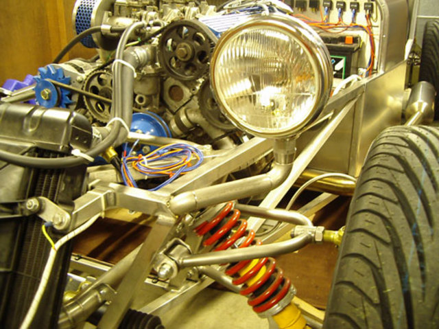

Every locost is having a pair of funny looking things at the top-corner of the upper rail.
If you place the diagonal exactly under the upper rail and place the second one exactly the same inwards. What happens?
Your arc which give u extra negative camber in roll will be smaller.
My Question is:" will anybody notice this when we drive it with less cambergain?"

There is a thread somewhere else on ears. I think you would seriously upset the steering geometry if you do what you propose, however if you leave the
upright and bracket where they are and plate the inside corners I think you could cut the ears off without any bother, the only question is why do you
want rid of them?

Hi, if you check out my Photo Archive, the second picture shows what I did, it seems to work fine, definately no problems with the steering. Regards
Chippy. Ah! actualy achieved it!!!
  Now fits within the body.
[Edited on 5-6-06 by Chippy]

I'm asking because i'm building the Tiger-avon by the book. Only my upper rail must be smaller to fit nose cone and bonnet.
So i've made it smaller, what happens similar to the picture.
the rest of the geo's is under control.
Bumpsteer, camber, roll-centre etc.
The only thing i don't get is that camber-gain-story. My camber-gain is now .3 degr by 25 mm drop.
Grtz

They're not ears, they're light bracket mounting points.
Paul G
