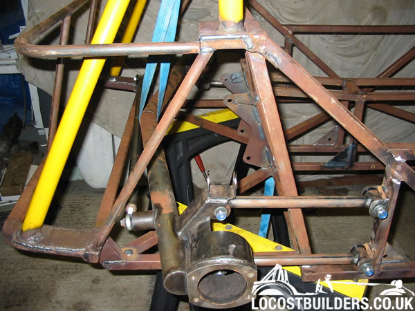

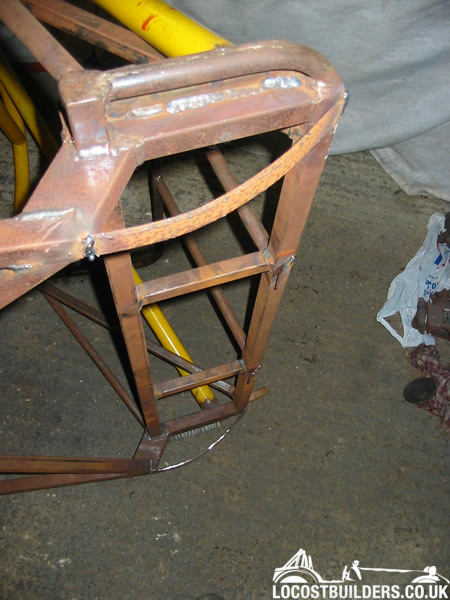

ned
| posted on 23/6/06 at 03:00 PM |
i won't argue with that Andy, just to compliment what you've said I beefed up the join between the flat bottom and the rear section by
using some 2x1" tube at an angle to transfer the forces in a "being rear ended" (ooerr) situation. pics in my archive.
http://www.locostbuilders.co.uk/upload/IMG_1006.jpg
http://www.locostbuilders.co.uk/upload/rear_venturi.jpg
[Edited on 23/6/06 by ned]
