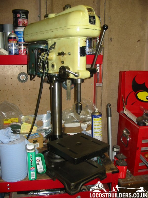

here's a pic of my drill with the 1/4" chuck:
and here's a pic of another of the same make/model with a 1/2"chuck:
I know that I can get a 1/2" chuck for the morse 1 taper but it looks as if my drill has a sleeve/converter from morse 2 to morse 1, hence the long bit sticking down that the morse one chuck is attached to. Does anyone think this is right and if so how do I remove it from the headstock so I can fit a normal morse 2 chuck?

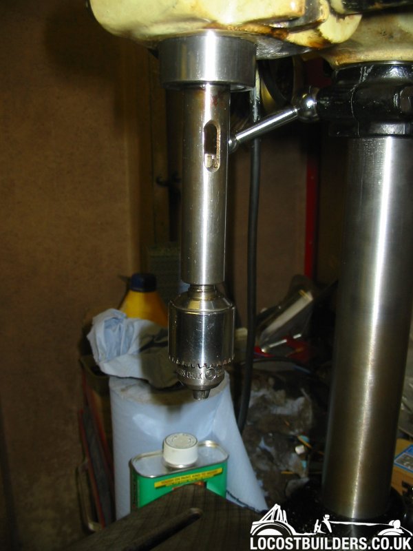

It is the exact same drill as I have and there is a slot in the spindle extension , there is no need to pull the spindle down it is there normally.Make a taper drift from a bit of 6mm plate with a shallow taper from about 10mm to 25 mm over about 150mm long , this will then remove the chuck easily. The correct drift could be bought from most engineering suppliers.
Although stated as 1/2 inch capacity I have used larger drills in mine with a little care in use.

I can see the slot in the spindle extension, pic here so removing the chuck looks simple enough:
http://www.locostbuilders.co.uk/upload/IMG_2164b.jpg
but i thought the extension was removble aswell as the picture/manual of the same model drills with 1/2" chucks haven't had any extension fitted?!
paulf is yours a 1/2" chuck on a morse 1 taper extension?
do you see what I'm getting at?
Ned.
ps here's another pic after cleaning it up a bit, I am yet to refit the depth stop and safety guard.
http://www.locostbuilders.co.uk/upload/IMG_2167b.jpg

Most reasonable drill chucks have a removable arbor. This is just a short self locking taper that goes into the chuck body and the other end is ground to 1, 2 or 3 morse etc to fit the drill. They can be difficult to remove from the chuck end however and with the cheap rices for 1/2" chucks these days I wouldn't bother.
You could also have an adaptor sleeve fitted into the spindle which is just 2 morse on the outside and 1 morse on the inside. if you have one of these fitted when you replace the chuck it would be better to remove it as they increase the spindle overhang. For a new chuck look at ArcEuro Trade, or RDG Tools Online, JL or any of the other importers. Most of the chinese stuff (tooling) coming in at the moment is reasonable quality.
Morse tapers are known for their difficulty in removing so a good drift as described above will be worthwhile. When you remove the chuck and adaptor the spindle taper will let you use much larger drills that have morse taper ends, these can be bought very cheaply at car boot sales etc and are reasonably easy to re-sharpen once you have the hang of it. With the adaptor you will be able to use parallet shank drills via the chuck, and 1 and 2 morse shank taper drills via the spindle and the adaptor. These are excellent drills and will no doubt last you several lifetimes.
