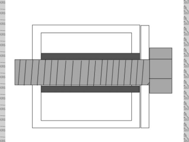

| posted on 1/10/06 at 04:43 PM |
Sleeve the hole
Drill it larger at the back and use a spreader plate or repair washer to hold the sleeve in then screw a seat belt eye bolt in from the front. you
could use a spreader plate both sides to distribute the load.
[Edited on 1/10/06 by Peteff]
RazMan
| posted on 1/10/06 at 04:53 PM |
Thats the neatest solution and I love the harness eye idea, but surely that means I will have to do something I was trying to avoid - drilling large
holes in my main chassis rail (even larger with a sleeve) potentially weakening it
[Edited on 1-10-06 by RazMan]
