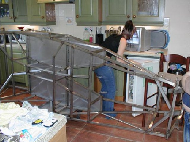

Micael
| posted on 17/1/07 at 07:38 PM |
Why do you have the chassie in the kitchen?
Micael Moose Åman
Petrolhead and all around nice guy
"Don't leave the duck there. It's totally irresponsible. Put it on the swing, it'll have much more fun." //Sleep Talkin Man Dec 23
2009
madteg
| posted on 17/1/07 at 07:45 PM |
chassis in kitchen
BECAUSE I CAN
